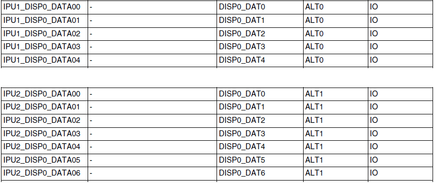

Some question about display interface of IMX6Q:
1: As meationed in data sheet "Up to four interfaces may be active in parallel"  and external signal describes in Reference Manual "Table 37-6. IPU1 External Signals" , can i connect 2 display panel via 24bpp RGB LCD Display interface(IPU1-DI0 & DIi1)
2: As external signal describes in Reference Manual "Table 37-7. IPU2 External Signals", IPU2 only support DI0 and data port is use same pad with IPU1-DI0,is it right?
3:Want connect 4 display panel via 2X 24bpp RGB LCD Display interface & 2X LVDS,is it possible?
Thanks very much!

in general i.MX6Q has 2 IPU modules and 2 display panel via 24bpp RGB LCD can
be supported, provided there are external signals for these interfaces, please check
Table 4-1. Pin Assignments i.MX6DQ Reference Manual
https://www.nxp.com/docs/en/reference-manual/IMX6DQRM.pdf
May be useful to use PINS-TOOL :
Pins Tool for i.MX Application Processors|NXP
2 lvds also supported according to Table 39-3. LDB External Signals.

alex_li
Thanks igor!
Answer of Q1&2 is very clear.
Q3" IMX6Q can support 4 display panel via 2*24bpp RGB LCD + 2*LVDS at the same time.Is it right?" need be confirm again.

igorpadykov
Hi min
please use PINS-TOOL  to check if such mux option is possible.
igor

alex_li
igor:
   no error report when use Pins Tool.Thanks again!!!

igorpadykov
Hi min
if PINS-TOOL does not report mux option problems, then this is possible.
igor
