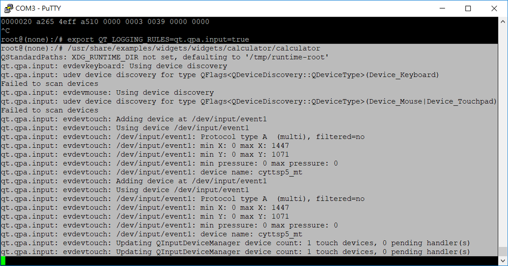

   I build Yocto with QT as below:
            DISTRO=fsl-imx-fb MACHINE=imx6sllevk bitbake fsl-image-qt5-validation-imx
   Burn this image in IMX6SLL board, and run below QT test app, but touch screen have no any response
           root@imx6sllevk:~# /usr/share/examples/widgets/widgets/calculator/calculator
 The QT env settings are:
          export QT_QPA_PLATFORM=linuxfb:fb=/dev/fb0
          export QTDIR=/usr/lib
          export QT_QPA_FONTDIR=$QTDIR/fonts
          export QT_QPA_PLATFORM_PLUGIN_PATH=$QTDIR/plugins/platforms
          export QT_QPA_GENERIC_PLUGINS=evdevtouch:/dev/input/event1
          export QT_QPA_EVDEV_TOUCHSCREEN_PARAMETERS=/dev/input/event1
   The touch event does work when touch in console command:
           root@(none):/# cat /dev/input/event1 | hexdump
              0000000 a265 4eff a510 0000 0001 0145 0001 0000
              0000010 a265 4eff a510 0000 0001 014a 0001 0000
              0000020 a265 4eff a510 0000 0003 0039 0000 0000
   How can I debug this issue "why touch can't work in QT app" ?

 When add QT debug message :
              export QT_LOGGING_RULES=qt.qpa.input=true
 Have touch message show:              touch.png
