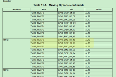

I am trying to get my PWM started using QTIMER2_TIMER0 for GPIO_DISP_B1_01 (D13). Here is my code setup from the driver example:

Hi @DFaulkner ,
   Not all the pins can be used as the QTIMER2_TIMER0 PWM pin, please check the IO chapter:
When you select the related pin, you also need to configure it in the pin_mux.c, please check the current SDK code for QTIMER.
SDK_2_11_0_MIMXRT1160-EVK\boards\evkmimxrt1160\driver_examples\qtmr
Wish it helps you!
Kerry
