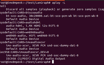

I have prepared an SD card boot setup for the i.MX8M Plus platform. My goal is to install PyAudio and run a real-time speech-to-text application using OpenAI's services.
While doing  this
when i try to record or play an audio using the commands
arecord -D sysdefault:CARD=wm8960audio -f cd -t wav -d 5 MJ_recorded.wav
aplay -D sysdefault:CARD=wm8960audio  MJ_recorded.wav
is working well
Below is the screenshot for sound devices listed using aplay
while,
trying to get the sound devices list using pyaudio i got nothing
(Installation done by usng pip install pyaudio)

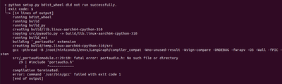

1.  i have installed pyaudio by using the pip command --> pip3 install pyaudio
But..

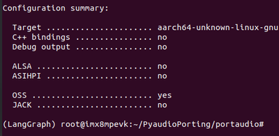

2. While installing the pyaudio ,it is asking for the portaudio ,So i download the latest portaudio v19 from the link
https://files.portaudio.com/archives/pa_stable_v190700_20210406.tgz. and starts installing.
While running the comand ./configure
i got the log

The PyAudio is not supported by default on our BSP. I suggest you confirm that have added the corresponding packages correctly to support this feature and contact software provider to troubleshoot this issue.
