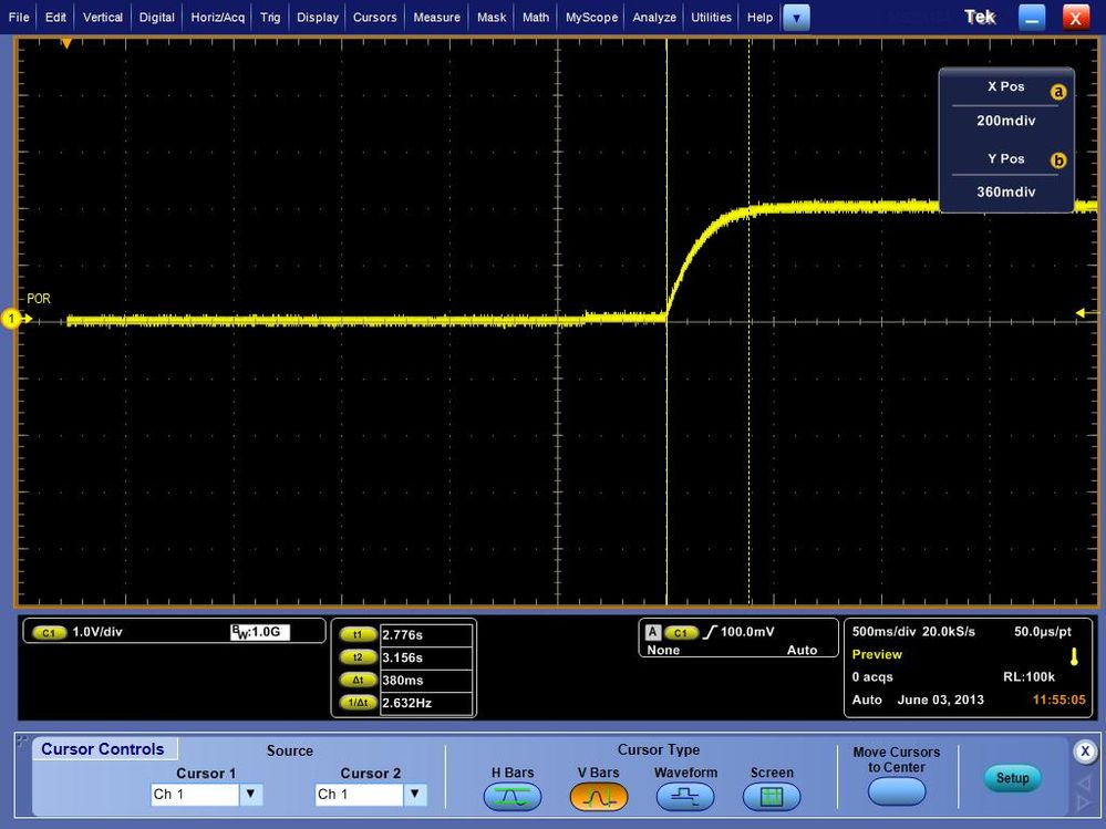

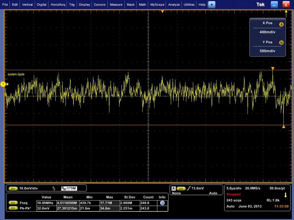

shinengsong
Hi Yuri:
  Please refer the following picture about ripple ,power up ,POR.SYS RIPPLE.jpg
13,004 Views

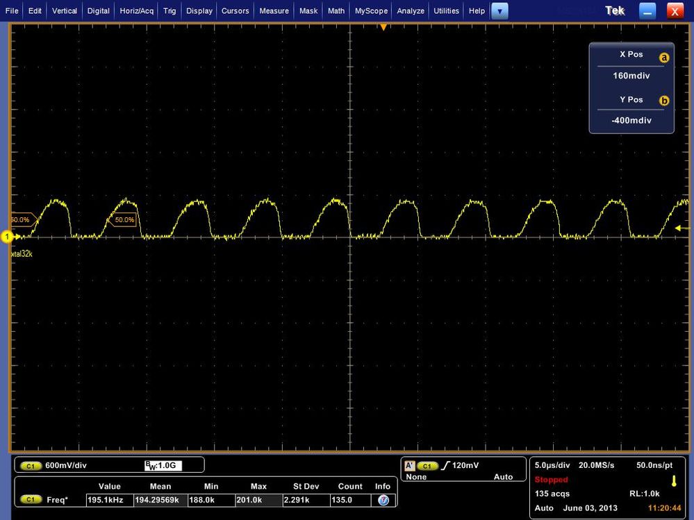

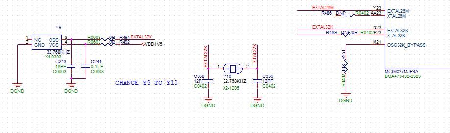

Hi Yuri:
I modified crystal Y9 to Y10(please refer the following picture) then measured
the signal of 32.768KHZ and find it's improper(frequency and voltage level is shifted)32KHZ.JPG
13,004 Views
Yuri
As for 32Khz - the waveform is correct for XTAL output.
13,004 Views
shinengsong
Hi Yuri:
As for 32khz,the crystal is 32.768KHZ,but measured frenquency is 195KHZ.
13,005 Views
Yuri
As for 195 KHz - please check crystal connection, using manufacturer recommendations.
Maybe a PCB issue takes place.
13,005 Views
shinengsong
Hi Yuri:
The 32KHZ issue have been  solved,,but mistake "Connection error. Please reset the board and make sure the board in bootstrap mode."is still existent.
