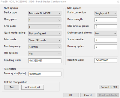

marek-trmac
Hi Ivo,
I do not know if this issue was resolved. I'm trying MCUxpresso Secure Provisioning tool v6 with MIMXRT685-EVK board. I have selected "Flex SPI NOR/MX25UM51345G" (same configuration as Marek Vitula above) and I do not find any problem. I can program the plain image both using UART and also USB.

### Configure FlexSPI NOR memory using options on address 0x0010C000 ###
blhost -t 5000 -p COM38,115200 -j -- fill-memory 0x0010C000 4 0xC1503057 word
"command": "fill-memory",
"response": [],
"status": {
"description": "0 (0x0) Success.",
"value": 0
blhost succeeded
blhost -t 5000 -p COM38,115200 -j -- fill-memory 0x0010C004 4 0x20000000 word
"response": [],
"status": {
"value": 0
blhost succeeded
blhost -t 5000 -p COM38,115200 -j -- configure-memory 9 0x0010C000

 There might be problem to configure the memory twice, try to reset the board before each programming cycle.
Note: MCUxpresso Secure Provisioning tool internally uses SPSDK applications (blhost) to communicate with the processor.

MarekVitula
Hello Ivo,
I see a problem with your script. The Macronix Octal SDR memory you are trying to use is connected to port B on evaluation board. It means that you have to specify the second configuration word.

Regarding the first problem you have encountered. The first part of SRAM is reserved by ISP, that's why the command ended with "Memory range invalid" error. The SRAM should be accessible from address 0x0001c000. You should use the write-memory command instead and specify the address.
Regarding the external memories configuration. To use an external memory device correctly, the device must be enabled with the corresponding configuration profile. If the external memory device is not enabled, then it cannot be accessed by the ROM ISP command. The boot ROM enables specific external memory devices using a preassigned memory identifier.
FlexSPI NOR memories can be configured by 32 bit configuration word.
1. First step is to write the configuration word to SRAM using the blhost fill memory command. Refer to the table "FlexSPI NOR Configuration Option Block" 1069 in the RT6xx User Manual.
blhost -u 0x1FC9,0x0020 -j -- fill-memory 0x10c000 4 <configuration word>
2. Call the configure-memory commmand that tells the boot ROM to generate the whole FCB (512 B flash configuration block) and configure the FlexSPI.
blhost -u 0x1FC9,0x0020 -j -- configure-memory 9 0x10c000
3. The ROM also supports programming the generated FCB to the start of the flash memory using a specific option "0xF000000F"
blhost -u 0x1FC9,0x0020 -j -- fill-memory 0x10c000 4 0xF000000F
(program FCB to the offset 0x400)
The second step is missing in the attached script, that's why it failed with "Invalid argument errror". Because no memory was configured, so the FCB block could not be programmed.

Thanks nxf46245, those pointers were very enlightening.  I missed the "ext_memory_setup.sh" script generated by the SEC tool.
However, I still have trouble replicating the commands generated by the SEC tool, with the command line tools from the SPSDK instead:
