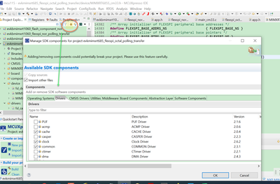

I am work on that processor and MCU XPRESSO IDE  so I want to know what is the process of merging the module driver software into one file.

Hi @Deepaksingh123 ,
Please follow the following picture:
You can add any other SDK driver to your one project demo.
Wish it helps you!
