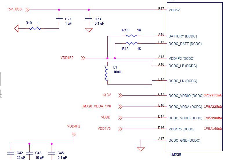

We use external +5V (or USB if available) to power the PMU through the VDD5V but the voltage levels are a little strange:
VDDIO 3.155V
VDDA 1.797V
VDDD 1.175V
VDD4P2 0.838V
VDD1P5 0V
The first three are reasonable, but the VDD1P5 is not used and has only a 33uF capacitor connected. VDD4P2 seems odd too and is not used externally.
The PMU is configured according to the i.MX23 reference design with 5V only (no battery).
The DC/DC inductor is in place.
Current consumption is around 110mA@5V.

The i.MX23 reference design is more or less exactly as your design. I read in another post that the PMU is identical. I later found an i.MX28 ref-design that was the same. Our design can be powered by external 5V, USB or PoE with no support for other memories than onboard NAND-Flash (and RAM). No battery. I have it running off of external 5V for now.
I get the power rails powering on in sequence and they are nice and clean. The clock turns on fine and the debug port prints the two error messages per above post. This lead me to believe the device is up and running as intended but when the USB cable is connected to USB0 neither Windows nor Linux recognize the device and I cannot get the RAM bootloader loaded. I have been trying to get it running with different modifications for a couple of days now without success. As it doesn't run anything else than the basic ROM-code (measured peak current @ 5V ~250mA), the regulators should be able to handle it.
An extra EVK is in the mail now so that I can compare the two designs at the signal level. Hopefully I will find something then.
The documentation describing what is going on at power on is somewhat lacking so it took a while before I got to know the 4.2V and the DC/DC is not started until much later. That ghost I chased for a while...

The 4.2V is not loaded by anything other than the two 1k resistors per the i.MX233 reference design (connected to DCDC_BATT and BATT) and the 33uF. Measuring resistance when powered off is high impedance on both the 4.2V and 1.5V.
I understand some high currect event during power on can stop it from working properly. What do you suggest I start doing? Measuring voltage turn-on sequences?
Jan

VDD 4.2V starts to rise at the same time as VDDIO but starts to drop slowly again after ~3ms. It never reaches more than ~0.8V.
Jan

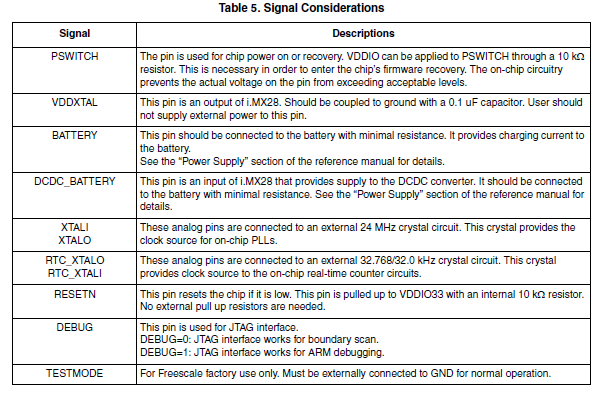

jimmychan
What are the following pins connected to? Please double check the following pins are connected properly. For details, please read the Table in Special Signal Considerations in i.MX28 datasheet.
11,413 Views
Jan_E
They are all connected per the table except DEBUG that is unconnected (freefloating).
What can cause the 4.2V to be unoperational but the VDDIO, VDDA and VDDD operational? From what I understand the only difference between them is the current limiter to the 4.2V. The DC/DC doesn't seem to work (from the lack of 4.2V?) so the voltages measured must be from the internal linear regulators that are supposedly weak but are enough to power the external memories leading me to believe there are at least no short cuts. The information on the PMU is however far from detailed so it is not easy to pin-point the source of my problems.
I'll start isolating the i.MX28 and see where that leads. Any further help is of course welcome!
Jan

Hi Jan
processor behaviour greatly depends on fuses, so one can compare
fuses on i.MX28 EVK and custom board for example with OBDS fuse example
(can be run with jtag) and check sect.12.3.1 OTP eFuse Table 12-8. General ROM Bit MCIMX28RM
such as ENABLE_PIN_BOOT_CHECK fuse and others
one can also check p.15 imx28_evk_revD_sch.pdf boot selection and 24MHz crystal
