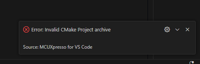

I have a problem to import e project that we have modified that is the hello world for use it for try to change color to the rgb pwm led but when I try to import it says invalid CMake project archive, there is the possibility to resolve this problem?

Hi @Chavira ,
The external project is imported now, but it's say that can't debug because can't crate a cmake build why?

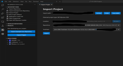

I'm using MCUXPRESSO extention to import a project, but not from the demo, I have imported a project that we have modified but when I try to debug it says that cn't debug because can't crate a cmake build why?

Chavira
Hi @geb!
You can import a local project too.
I have tried without problems.
You have to select the toolchain and the sdk path.

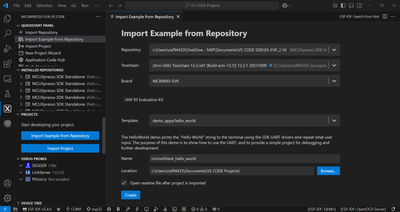

You should use the MCUXPRESSO extention to import a project:
Best Regards!
