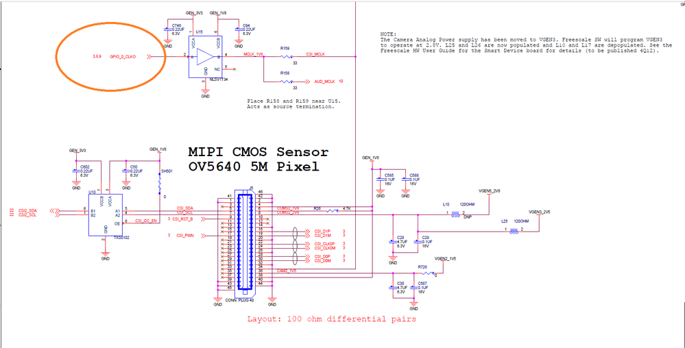

But even I setting the dedicated voltage, I am not get the expected output.
The schematic we are used is same with reference sabresd as below: The CSI mclk is from GPIO0_CLK0,
But I do not captured the sci_mclk with scope on both reference board MCIMX6DL-SDB and customer board, through the ov5640 and 5642 is not solder on the board but this clk is provide by imx6DL it should be there.
What is wrong or any configure I am lost? Does somebody else encounter the same issue?
