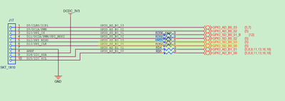

I have a MIMXRT1060-EVKB board and am trying to follow the LPSPI loopback example.
The board is based on schematic SCH-47858 Rev B
In the readme it states:
"Board settings
Remove the resistor R305 and weld 0Ω resistor to R346,R362.
LPSPI:
MASTER connect to MASTER
Pin Name Board Location Pin Name Board Location
SOUT J17-4 SIN J17-5
I am concerned these instructions do not apply to my board as they do not make sense.
R305 is connected to the USB Fault pin, which does not seem relevant to the demo. Also R346 and R362 do not match up with MOSI and MISO on my schematic.  Are there any errata to the readme? The readme would be more useful it if it explained what the resistor changes purpose is,

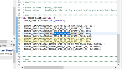

   Which SDK version you are using for the MIMXRT1060-EVKB?
  As I didn't find your mentioned loopback example, please check the following picture from the newest SDK:
I checked the demo, also no related board settings like you.
So, I think, your refered code is not for the MIMXRT1060-EVKB.
Please download the newest SDK code and try it again:

R305 is not necessary, but the R346,R362 is must.
Otherwise, you connect J17-4 and J17-5 is not working.
You need to refer to the correct schematic.
