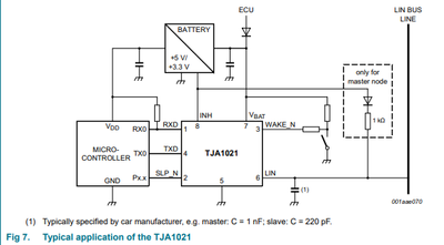

i am using LIN Interface and for the PINS DI_MCU_LIN_RX - K1 and DO_MCU_LIN_TX - L1.
Which function i need to choose during Port Configuration
Do we have any guidelines to choose port configurations.
1,256 Views
Omar_Anguiano
Please refer to the following diagram.
LPUART can be used since it can emulate the LIN bus.
