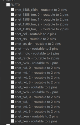

I have been using iMX Config Tools to identify GPIO compatibility, but do not see NAND_TREE# listed with the other ethernet signals. Are there any restrictions with this signal?
Devices:
iMX8ULP
KSZ8081RNB
I appreciate your support!

Hi @AldoG ,
I am using Config Tools for i.MX v 14 as there were compatibility issues with newer versions of config tools not being able to read our .mek.
I am investigating signal ENET_NAND_TREE#. The EVK board this signal going to PTE21, but we need to use PTE21 for ENET0_RXD0. So I am trying to see if there is any GPIO compatibility issues that I need to take into consideration, but do have that signal listed in config tools. That probably means that any GPIO will do, but wanted to confirm.

AldoG
Got it, I do see even on the image you have shared that ENET0_RXD0 is indeed there, from up to bottom is the number 13.
The 2 available pins are PTE21 (Which is the one on the EVK) and PTF1.

AldoG
This may be due to the old version of the tool is using an old configuration for the processor, since as you can see there is no FlexSPI signals routed to PTE21, and it is safe to use it as ENET0_RXD.
Also, an small mistake from my side as I notice that i.MX8ULP EVK we use PTF1 for ENET0_RXD, but as said above there is no dedicated or FlexSPIx signals that can be routed to PTE21.
