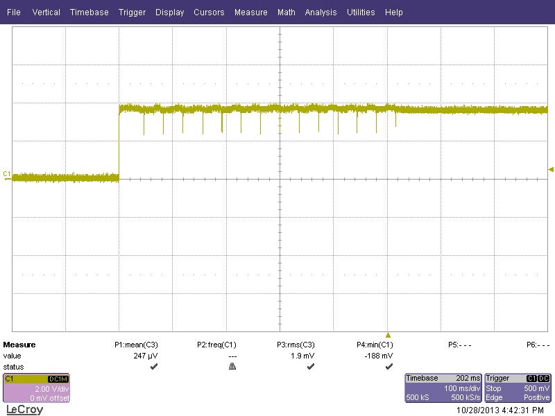

Based on SDP. The system is battery powered, using one single cell Li-P battery. Differences with SDP on power section: SDP uses two chargers (MAX8903); whereas my system uses one charger (MAX8903).
Symptoms

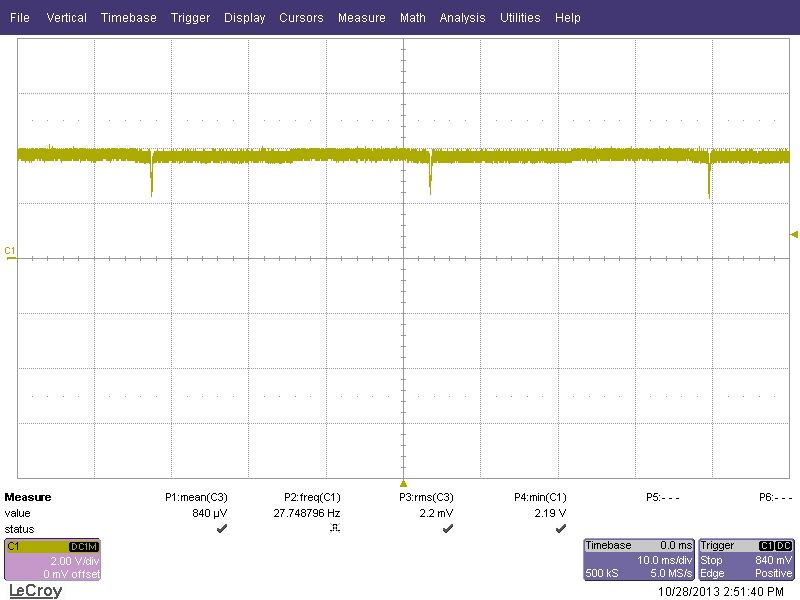

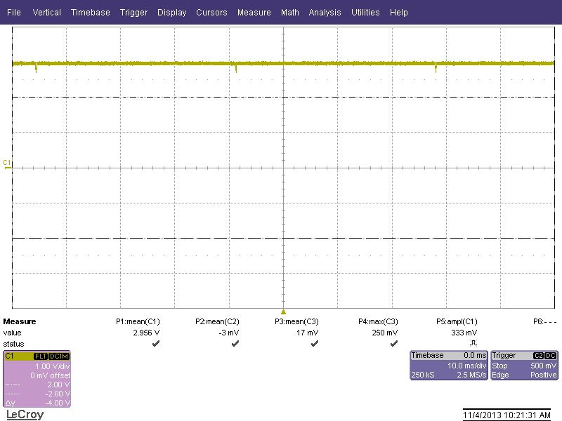

Upon power button press, system fails to boot, with LCD and on-board LEDs blinking. Input to PMIC, PMIC switching outputs all exhibit severe dip every 37ms. VSNVS and IMX6_ONOFF also dips slightly. If the battery is removed and re-plugged again, the system can always power up without fail. There are still dips in voltages, but they quickly settle down.
PMIC Input at pin 23 (below):
PMIC switching ouput VDDCORE (below):
VSNVS (powered by external LDO) also dips slightly (below):
IMX6_ONOFF (below):
If battery is removed and re-plugged, there are a dozen dips and then the supplies all stabilize. The system can always boot up successfully. Shown below is Vin to PMIC:

JorgeRama_rezRi
Hi Zhao,
Ok, I think I know what's happening. I assume your battery is 3.7V, right? If so, 60% of that voltage is too low. The MMPF0100 only assures correct functionality when VIN > 2.8V, so if your battery is discharged below that voltage, it will have trouble with power-on events, so you have to charge it again when it reaches this point. Is this the case?

jh_zhao
Hi Jorge
Thank you very much for the attached latest revision of SDP and sorry for following up late.
I've measured VCOREDIG and VCORE, both of them exhibit severe drop. But I've not measured VCOREFEF and haven't tried out the capacitor changes. However, I've some new findings so far.
Finding#1: If charger (MAX8903) is bypassed by connecting battery to SYS_4V2 domain, the board can boot up consistently. Tested over 4 boards and 2 batteries across different battery levels.
Finding#2: After adding 2.2mF cap to SYS_4V2 domain (original circuitry, charger is in-between battery and SYS_4V2), the board can boot up consistently. So far I've only tested on one board.
To answer some of your questions:
What's the current being drawn out of the battery when the voltage drops occur?
Current spike is exceeding large, see below:
Another possible issue is the battery itself. Could you please try replacing the battery with a DC voltage source with the same capabilities of the battery?
Tried simulating battery using DC (DC connected to charger BAT pins), board can only boot up when DC is equal to or greater than 4.1V.
If 4.2V DC is fed into SYS_4V2 domain and battery is removed, board can always boot up.
If 5V DC is fed into DC jack and battery is removed, board can always boot up.
Thanks & regards,
Jihua.

JorgeRama_rezRi
Hi Jihua,
Ok, so the problem seems to be PMIC input capacitance then. How much capacitance do you have at the SYS_4V2 node? Please note that our SDP has around 155uF. Is incrementing the capacitance a suitable workaround for you? If you need any more details about PMIC input capacitance, I can contact the designers.
