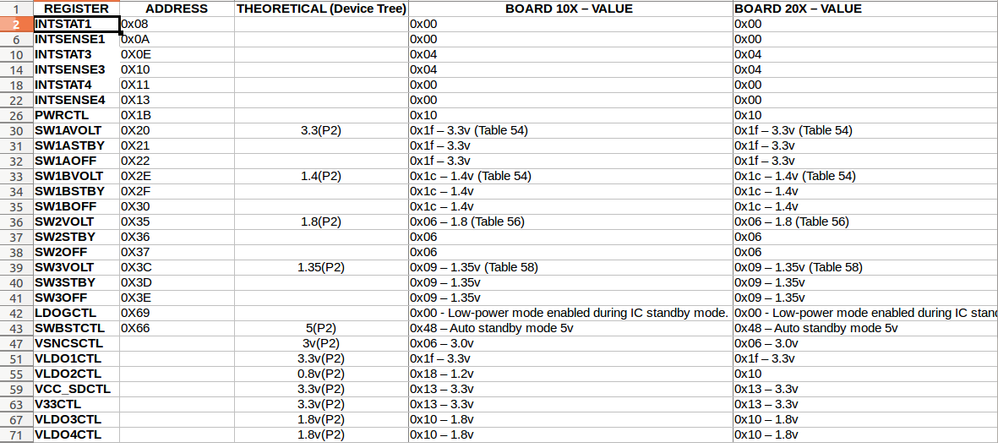

Hi everyone,
I continued taking values of the PMIC registers of two different boards, and both give the same values, as you can see below:
There are only two strange things that may be interesting:
The VPWR bit of INETSENSE3 register is set (1), meanwhile the VPWR PMIC input is connected to GND. Because, I am not interested in input voltages higher than 4.5v, therefore I cannot understand why the PMIC is indicating that it is an over voltage.
Following the 6.3.5.1 data sheet section, if the main supply is Vin and it is lower than 4.5v, you can remove the FET MP1 and the VPWR pin to ground, therefore I think that I follow the correct instructions.
This is related to the second strange thing that I found, I am not interested in the LDO low-power mode, but as you can see in the picture, the register LDOGCTL is set (0), it means that the mode is activated. However, I think that it does not have any effect on the PMIC because It has not been installed the proper hardware configuration.
If the Vin receives a voltage peak upper than 4.5v, is it possible that something wrong happens?? I do not have more clues...

igorpadykov
Hi Javi
according to Table 6. Electrical characteristics – front-end input LDO PF3000 datasheet
VIN max. is 4.55V, so higher voltage may cause device malfunction.
https://www.nxp.com/docs/en/data-sheet/PF3000.pdf
igor

pastrana
Hi Igor,
I know, Vin is used to be 3.55v on my board. Do you see anything interesting in the register values??

igorpadykov
Hi Javi
LDOs can be disabled due to overcurrent, this is described in sect.6.3.10.2
Current limit protection PF3000 datasheet.
So one can check schematic for possible excessive loads, also one can check STANDBY signal.
Note, one can obtain pf3000&i.MX6UL reference schematic creating service request.

pastrana
Hi Igor,
First of all, thank you for your quick answer. I am using the default configuration, therefore  following the data sheet the over current limit is disabled. Nonetheless,  I have checked its value asking directly to the device using I2C bus. And the result is the next:
   i2cget -f -y 1 0x08 0x1B
   0x10
Therefore it is only enabled the RESTARTEN bit.
Moreover, I have checked the STANDBY pin during this "error mode" and it does not change, it continue being 0. therefore, I guess that it may be coming in other strange mode. But I do not know what mode... Besides, I can force to go into standby mode, and when I check the PMIC outputs, they keep the same voltages values as in normal mode.
