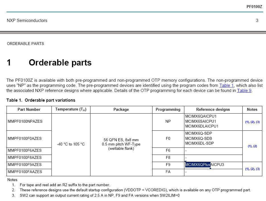

I am currently looking through the MCIMX6QP-SDB “i.MX6 SMART DEVICE SYSTEM” evk schematics now. I noticed in the MCIMX6QP-SDB evk they use the MMPF0100F9AZES which is the non-programmed part. On the NXP site I found a pre-programmed version of the PF0100 that supports the i.MX6DP. The part number is MMPF0100F9ANES. What EVK uses this part?

Hi Adam
MMPF0100F9AZES, used parts can be found in BOM file included in schematic
