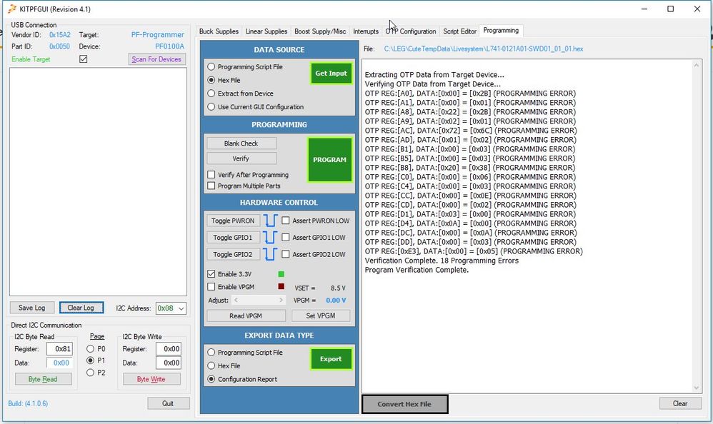

legbam5
The verify after programming shows errors.
After repowering and verify "NO programming erros" appears.
I don't understand it.
The error code 0x05 in fuse bank 0xE3 is not descibed in AN4536.
6,791 Views
reyes
Can you please check if the PMIC is already programmed before you try to program it, please?
You can do this by clicking on the “Blank Check” button.
If the PMIC is already programmed, it will not be possible to re-program it and this could be the cause of the programming errors you are seen.
