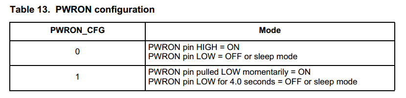

PWRON signal is used to turn on PMIC. It can be configured to detect a level, or an edge using the PWRON_CFG
bit as below. What's the default configuration of PWRON_CFG? 0 or 1?

Please see the datasheet page19 The default setting is level sensitive
