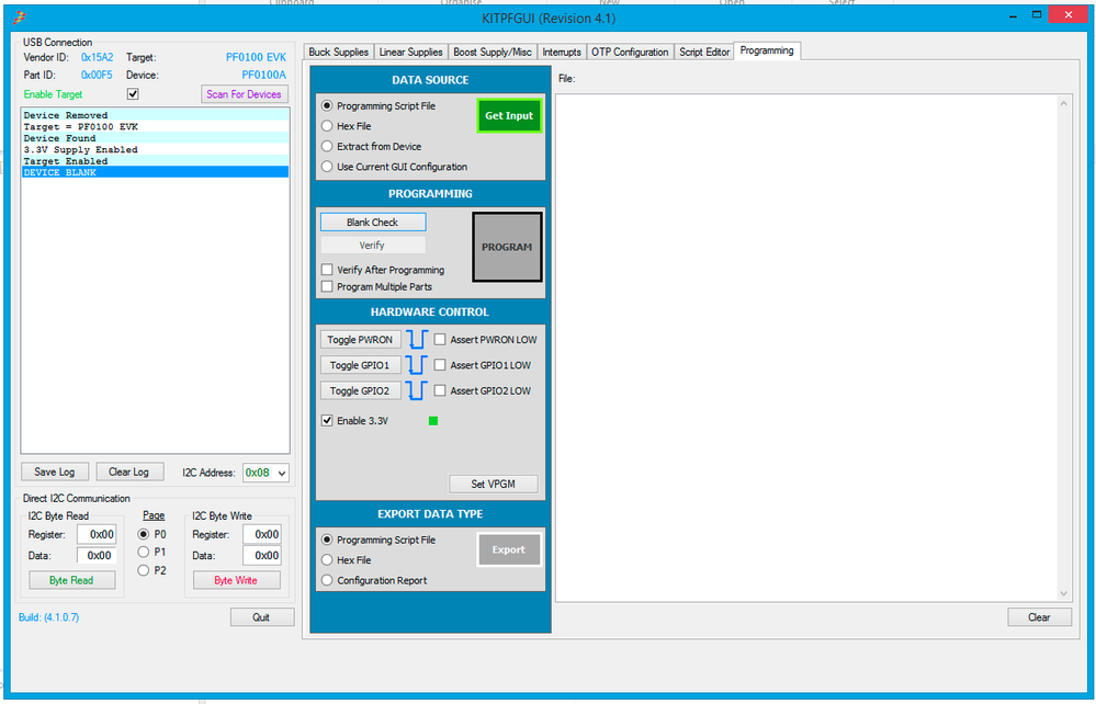

We have just purchased a PF Series Programmer ( KITPFPGMEVME ) with the intention of programming a custom configuration into a PF0100 PMIC that's been placed onto a new i.MX6 design of ours.
The issue we're having is that when we connect the programmer, the USB programmer enumerates with the Part ID 0x00F5 for the PF0100 EVK Target, which disables the OTP functions of the GUI. The PF0100 PMIC on our board is being detected correctly by the programmer, but we've been unable to figure out how to perform the OTP, as the PROGRAM button is disabled.
We are assuming the programmer should be enumerating with the Part ID 0x0050 and target PF-Programmer.
Any suggestions ?

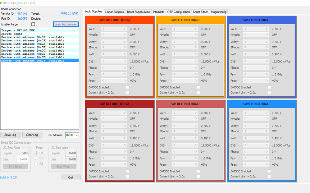

stevevandeweyer
Hi Jose,
Thanks for the response.
We've now tried the latest software on a number of windows boxes ( Windows 7 -> 10 ), and each time the programmer is coming up as PID 0x00F5.
We do not own the PF0100EVK kit, and this is the only programmer/dev kit we are attaching to the PC.

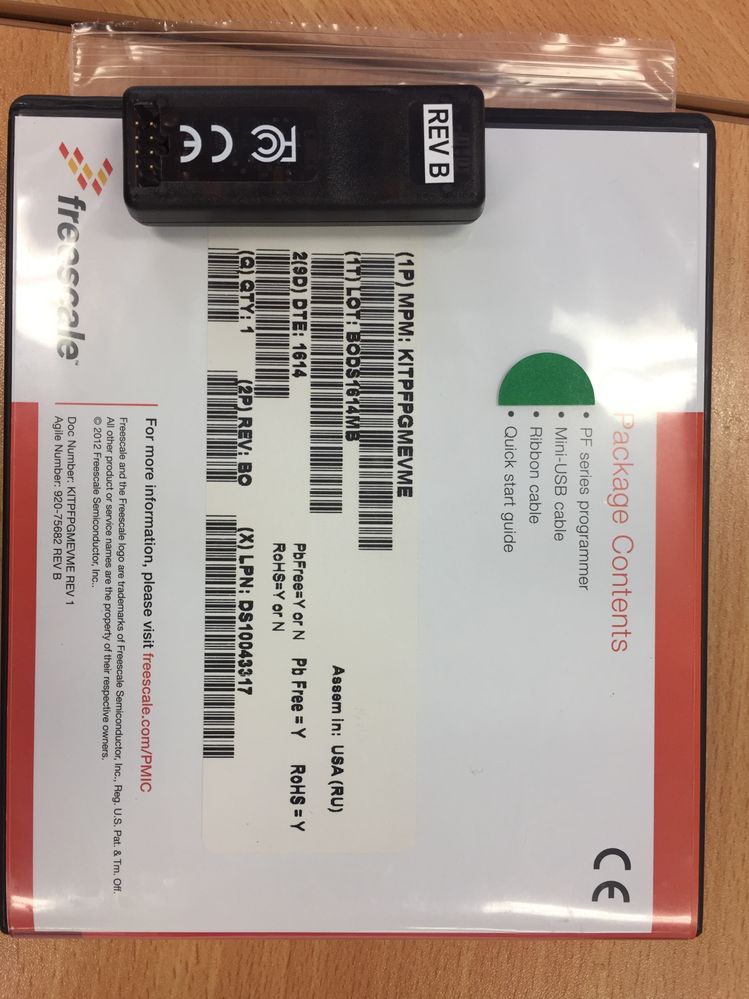

Any other suggestions ? Is it possible the programmer has been shipped with the incorrect firmware/USB configuration ?

If you persist in seeing the PF0100 EVK as your Target after this, you may have received a bad PF-Programmer dongle.

reyes
First, let’s upgrade you to the latest version of the GUI 4.3.0.0 (find it attached).
Please uninstall completely previous versions of the GUI, then install this new version of the GUI.
Now to the issue. On PF0100/0200 parts, we use the USB PID to determine which hardware is attached:
PID = 0x0050 à PF-Programmer
PID = 0x00F5 à PF0100 EVK
PID = 0x00F6 à PF0200 EVK
If you are seeing a PID of 0x00F5 even though you are connecting a PF-Programmer dongle, then your PC is somehow not releasing the USB device. If you are trying to connect to some other USB-to-I2C interface device, make sure that it presents a VID: 0x15A2 and PID: 0x0050. Otherwise the GUI will not enable the [PROGRAM] button.
Jose
