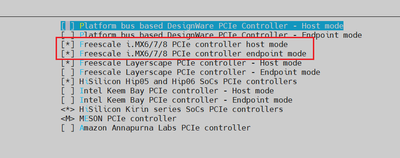

1) can you guide me to the file/code in linux kernel for the PCIe RP controller driver and also for PCIe EP controller driver?
2)  how does a RC Controller driver differs from the EP controller driver?
3) what are the role/responsibility/functions of a RC and EP controllers?
I want to buy two IMX boards which can act as PCI HOST and PCIe  EP, please suggest which boards will be fine . my use case is just to test out the complete basic PCIe end to end and how the EP RC talk to each other.

RC driver & EP roles are both supported in pci-imx6.c

2. About driver in linux kernel
Default configurations of Kernel have supported RC & EP driver.

the RC EP controller file structure in kernel is this, correct me if i am wrong:
     pci_subsytem <--> pcie_designware_host.c <--> pci_imx6.c <---> ROOT PORT CONTROLLER
     pci_subsytem <--> pcie_designware_ep.c <--> pci_imx6.c <---> END POINT CONTROLLER
