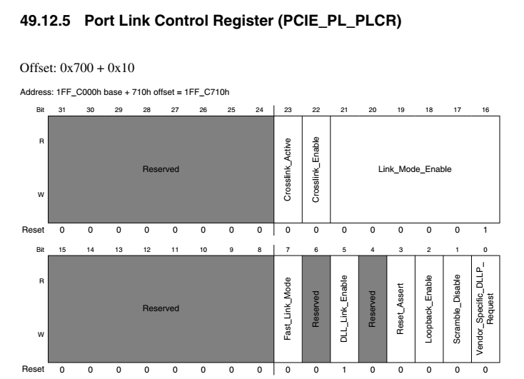

I am using iMX6 Solo processor and I want to have signal sent out through PCI-E Tx lane get loopback to the Rx lane. This means that Tx and Rx lanes should have the same signal. Is this done by setting the bit 2 (Loopback_Enable) of Port Link Control Register (PCIE_PL_PLCR)? Thanks.

igorpadykov
Hi Harry
yes this bit is used as part of Local PIPE Loopback procedure usually used
during production test. NXP software BSPs do not use this procedure.
igor

harrytan
Hi igor,
I have enabled the Loopback_Enable bit and did not get the same signal on both Tx and Rx lanes. The data is sent from a FPGA to the iMX6 processor (Tx lane of FPGA to Rx lane of processor) and I probed on Tx lane of processor using oscilloscope. I expect to get the same signal on both lanes.
I further read bit[54] (mac_phy_txdetectrx_loop PIPE receiver detect/loopback request) of DEBUG 1 (PCIE_PL_DEBUG1) register and this bit is '0'. Does this mean that the PHY did not get loopback request? Please advice, thanks.
