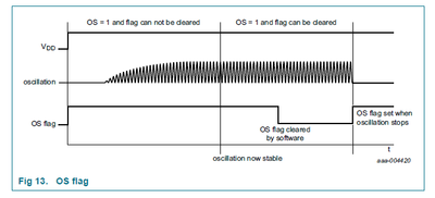

We constructed an IMx8x board with a PCF85063AT/AY RTC (schematic attached). The problem is that when I turn on the power supply, the oscillator stop bit is set. and the IMx8x driver reports power failure and discards the time. On the oscilloscope, I noticed misbehave in crystal pulse. The RTC OSCI pin is pink, and the OSCO pin is blue. When I switched the power supply from off to on, the pulse rate increased. How can we fix it?

Thanks for your response. yes i read the same in datasheet. So the driver i am using read this oscillator bit as corruption in time and show "power loss detected, time is invalid". so i there any way to not have oscillator stop bit get set making seconds register invalid for my driver.

The oscillator is considered to be stopped during the time between power-on and stable
crystal resonance. This time can be in the range of 200 ms to 2 s depending on crystal
type, temperature, and supply voltage.
so you can operate the OS bit after this period(200ms to 2s) when power on this RTC.
