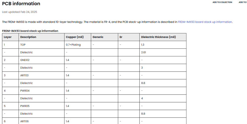

Hi NXP iMX93 Champ !
Could you tell me if the PCB stack-up data for the FRDM-iMX93 EVK is included in the design files? If it is, please specify which file.
It seems the PCB stack-up data for the FRDM-iMX93 EVK is not included in the design files. This information is typically not explicitly stated in the schematics or layout files. It is often provided in a separate document or a specification sheet from the manufacturer.
Thanks.
Jack

Hi @JK-IMX
Please refer user manual here:
https://docs.nxp.com/bundle/UM12181/page/topics/pcb_information.html
Zhiming

Hi Zhiming.
The file can not be found from the link you provided.
Would you please specify the file name also?

Hi @JK-IMX
We don't provide stack up file, but provide the layers information.
Zhiming
