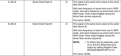

In the reference manual, we have seen the table 18.4 below which clearly states that the clock will be halved in DDR mode.

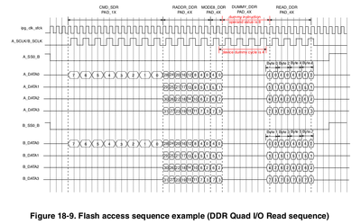

Also, the waveforms in the reference manual show half clock in DDR operations
From all these data from the reference manual, we understand that when we access memories in SDR mode the clock remains the same, but when we access memories in DDR mode the clock will get halved.
If the clock reduces by half during DDR, the actual data rate remains the same as during SDR and our actual goal of achieving the maximum data rate is not fulfilled.
1. Is this behavior correct?

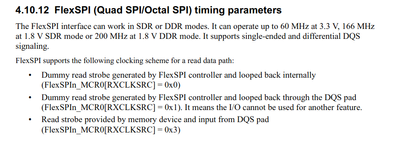

In the IMX8QXPAEC document, we have read the following under FlexSPI timing parameters.
2. Does this mean that we can access memories in DDR mode with the same frequency as SDR mode by changing MCR0[RXCLKSRC] register bits?
3. If yes, is there any document/procedure for that?

I think you are right, frequency can be changed using MCR0[RXCLKSRC] register
as described in Table 99-101 FlexSPI timings with FlexSPIn_MCR0

Thanks for the quick reply. I am a bit confused about that MCRO[RXCLKSRC].
Because when I tried to change RXCLKSRC to 0x3 in flexSPI driver I observed kernel panic. Then after looking into the reference manual I found this statement
Thah is why I am asking if there is any document or procedure which I can follow to achieve proper clock?
