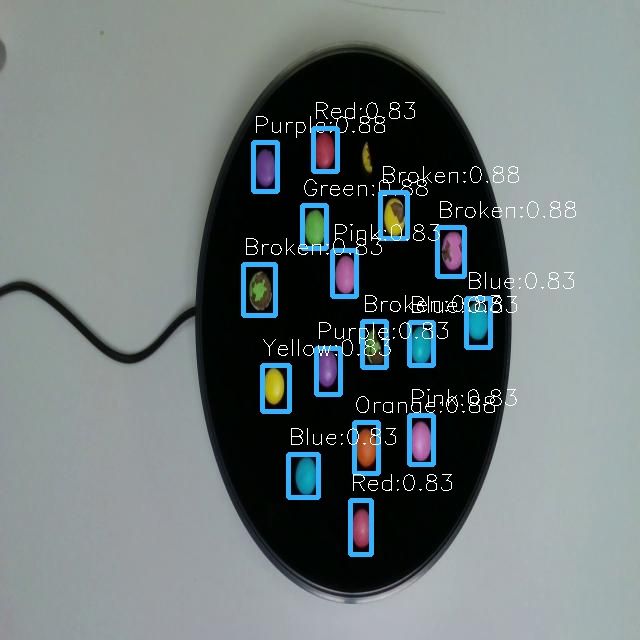

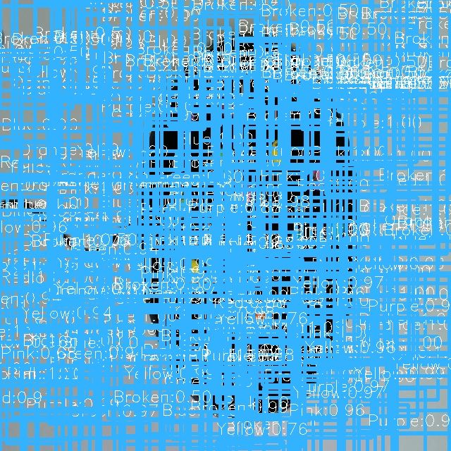

We have performed the training again with YOLOv5s with our custom dataset and try to do inference as you were claiming that YOLOv5 is giving good results with neutron converter in previous chat. The issue is still there with YOLOv5 as well. I am attaching the results as well for the reference. Where we tried with converted and non-converted int8 tflite YOLOv5s model.
Now, If you are claiming that YOLOv5 is giving good results then why don't you share the validated model with us. Please share all steps you are following from export, quantization to convert and what are the steps you are following for post-processing as well. So that we can validate your model and replicate the steps you have followed at our end.
Please share you benchmarking and profiling data with i.MX95 as well if you can share.
