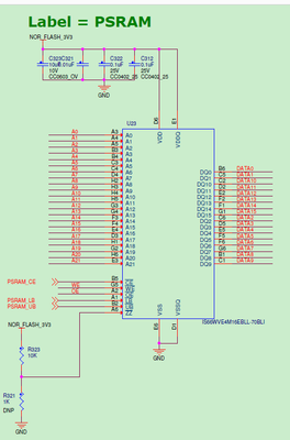

Using the MIMXRT1176CVM8A in an embedded application, but need to interface with a high speed SRAM with a 32-bit data bus.  Is there a way to do this somehow?

   RT1170 can support the 32bit SRAM, you just need to use the 32bit data signal based on the 16bit SRAM.
   This is the 16bit SRAM situation:
For the code, you can refer to the SDK:
SDK_2_14_0_MIMXRT1170-EVK\boards\evkmimxrt1170\driver_examples\semc\sdram\cm7
But you need to modify the code, to do the sram related configuration, eg, you use this semc_sram_config_t
Wish it helps you!
If you still have questions about it, please kindly let me know.
