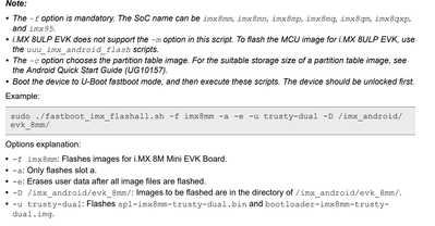

Hello @MarcelloSgarbi1
I hope you are doing very well.
Can you please try with:
sudo ./fastboot_imx_flashall.sh -f imx95 -a -e -u trusty-dual
As mentioned in the Android User's guide:
Also, please align with the UUU tool.
Salas.
