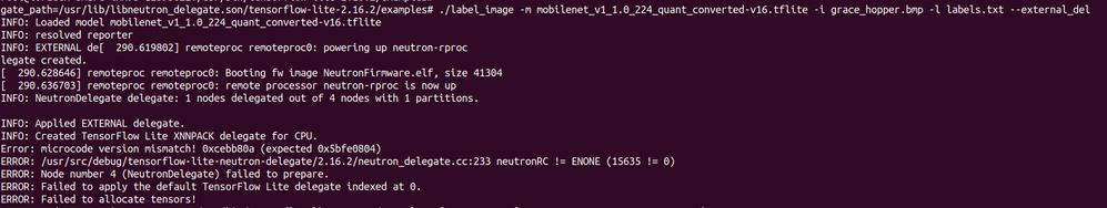

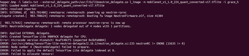

Sudharsun
    Thank you for your support. I reviewed the link you shared and followed the provided steps, but I’m still encountering the microcode mismatch error. I’ve attached a screenshot for your reference.
Screenshot from 2025-10-31 17-54-09.pngScreenshot from 2025-10-31 17-54-09.png
Could you please review this and help us resolve the issue?

ekho
I don't know this error, perhaps someone from NXP should jump in.

Sudharsun
The BSP version was upgraded from 6.12.20 to 6.12.34, and the default example from the eIQ toolkit was executed. The attached screenshot shows the result — the example successfully ran and produced the default image classification output on the NXP i.MX95 EVK. However, none of the 31 nodes were delegated during execution.
I converted my .tflite model using the latest eIQ Toolkit version 17. However, when I run the example with TensorFlow Lite version 17, no image classification results are displayed. I’ve attached a screenshot showing this issue.
Both of the above cases were executed on the NXP i.MX95 EVK.
However, our main objective is to run these examples on the Toradex SMARC i.MX95 EVK.
The BSP version upgrade on the Toradex board is still unstable, resulting in multiple errors when running AI workloads on the NPU, as the Toradex i.MX95 EVK does not yet have a stable BSP release for version 6.12.34.

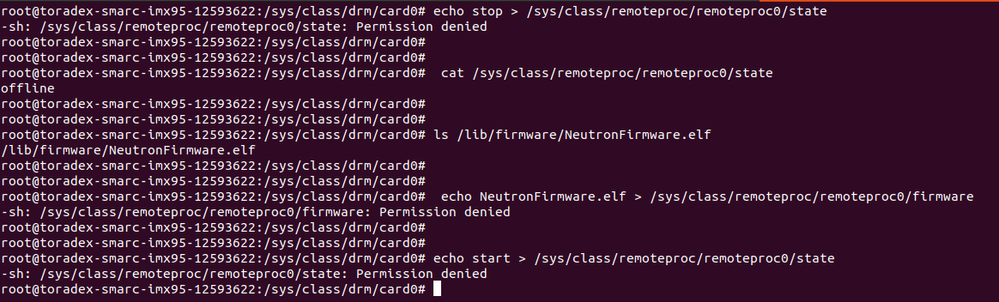

Sudharsun
   We have tried the below commands as per you suggestion still faced the errors like permission denied. We are trying the command in root and sudo also but still facing the permission denied issue. Have added the Screenshots for you reference.
1.echo stop > /sys/class/remoteproc/remoteproc0/state
2.cat /sys/class/remoteproc/remoteproc0/state
3.ls /lib/firmware
4.echo NeutronFirmware.elf > /sys/class/remoteproc/remoteproc0/firmware
Screenshot from 2025-10-16 14-57-17.pngScreenshot from 2025-10-16 14-57-17.png

Bio_TICFSL
Hi.
That is weird, so please make sure you have the latest BSP, erase and burn the linux again in your board, I can not said anymore since it works nicely right here.
