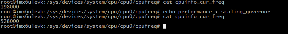

huabobao
Hi igor
Last nignt I do some operations as bellow:
you see,the cpufreq become highest,but  when i do reset(using watchdog timeout  way),the linux system suspend ,still not resset.
so I have some questions:
1. the above operations meet your suggestion ,"try to disable cpufreq driver" ?
2. Since u-boot can do reset ,can you tell me what addional setting in linux ,so it  failed to reset ?
Look forward to your favourable reply!
4,880 Views
igorpadykov
please verify that before reset VDD_SOC_IN, VDD_ARM_CAP voltages described
in Table 11. Operating Ranges i.MX6UL Datasheet are for 528MHz operation
http://cache.freescale.com/files/32bit/doc/data_sheet/IMX6ULCEC.pdf
There are no addional settings in linux preventing  failing to reset, it is necessary to make
in hardware.
igor
