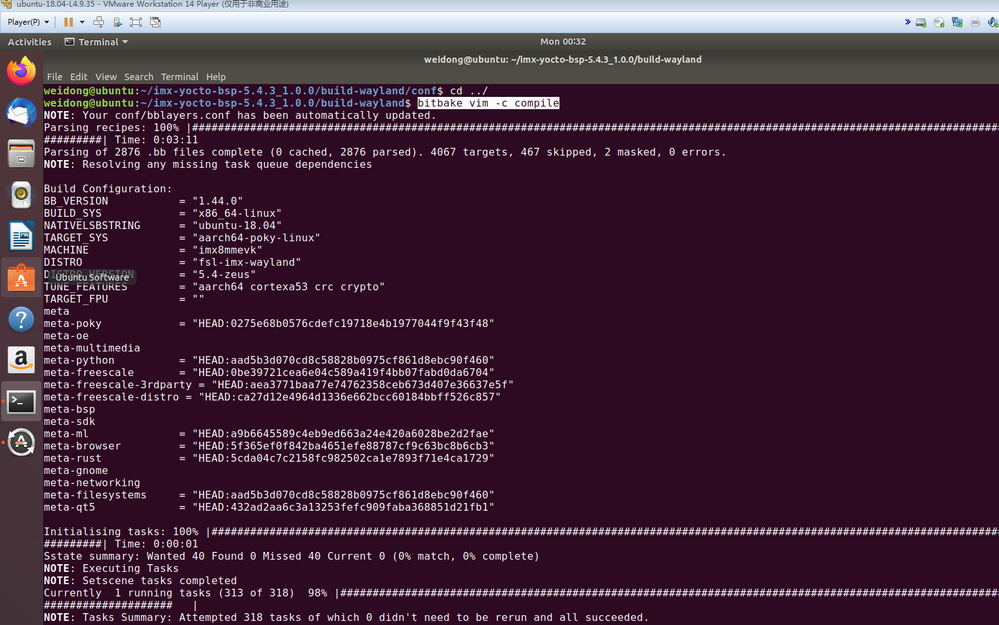

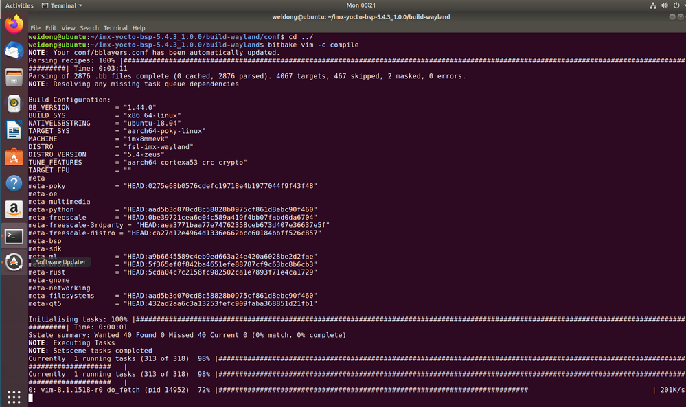

weidong_sun
Hello Sergei,
I tested it, see steps below, please!
1. cd ~/imx-yocto-bsp-5.4.3_1.0.0/
2. DISTRO=fsl-imx-wayland MACHINE=imx8mmevk source imx-setup-release.sh -b build-wayland
3. add vim to local.conf
MACHINE ??= 'imx8mmevk'
DISTRO ?= 'fsl-imx-wayland'
PACKAGE_CLASSES ?= 'package_rpm'
EXTRA_IMAGE_FEATURES ?= "debug-tweaks"
USER_CLASSES ?= "buildstats image-mklibs image-prelink"
PATCHRESOLVE = "noop"
BB_DISKMON_DIRS ??= "\
    STOPTASKS,${TMPDIR},1G,100K \
    STOPTASKS,${DL_DIR},1G,100K \
    STOPTASKS,${SSTATE_DIR},1G,100K \
    STOPTASKS,/tmp,100M,100K \
    ABORT,${TMPDIR},100M,1K \
    ABORT,${DL_DIR},100M,1K \
    ABORT,${SSTATE_DIR},100M,1K \
    ABORT,/tmp,10M,1K"
PACKAGECONFIG_append_pn-qemu-system-native = " sdl"
CONF_VERSION = "1"
DL_DIR ?= "${BSPDIR}/downloads/"
ACCEPT_FSL_EULA = "1"
IMAGE_INSTALL_append = " vim"
4. bitbake vim -c compile
So it is no problem.
Hope the test is helpful to you.
B.R,
Weidong

sergei_p
Hi Weidong,
I see now. The "vim" recipe builds for the "fsl-imx-wayland" DISTRO, but fails for me for "fsl-imx-xwayland". Could you please verify this? Thanks!
