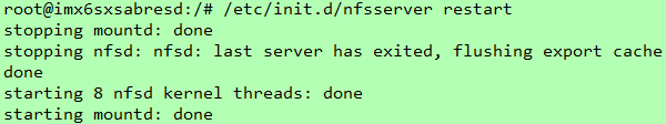

hi
I want to built NFS server on i.mx 6SoloX, the Client(Ubuntu 14.04) ping and showmount server is fine,  but want to mount server the rpc.mountd program will killed
server/Host(i.MX6), Client(Ubuntu 14.04)
the server can see these message
excute top before mount
excute top after mount
when rpc.mountd program is killed excute showmout -e localhost can see the error
Any idea as to what is causing this error?
Am I missing any other configurations?
Thank you
Bruce

b36401
Please check dmesg and /var/log/messages for crash reason.
By the way please make sure that NFS daemon support is enabled in kernel.
Also in case of unexpected process crashes you can check the RAM:
https://community.freescale.com/docs/DOC-96412
Victor

Dear Victor thank your reply, no crash reason message in /var/log/messages, and NFS daemon support is enabled in kernel
excute NFS server restart
Bruce
