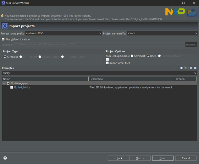

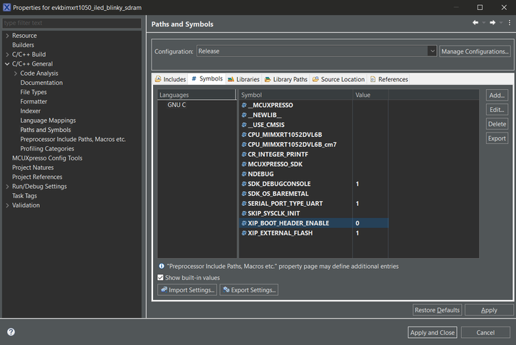

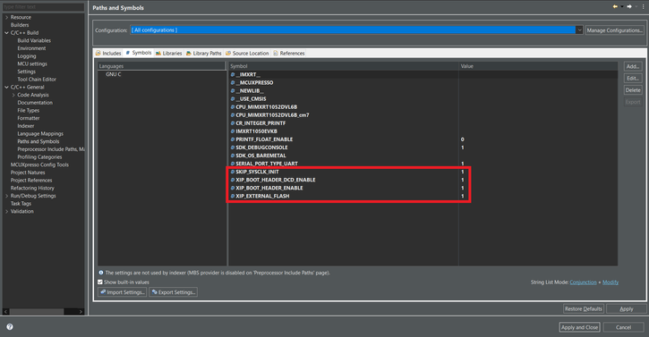

I picked evkbimxrt1050_iled_blinky demo application as starting point:

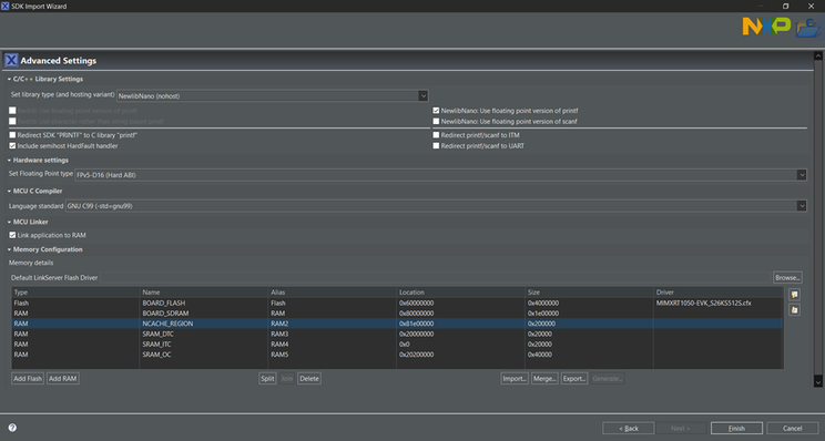

Because this project is configured by default to run using eXecution In-Place (XIP), while importing I immediately checked "Link application to RAM" and moved BOARD_SDRAM as the first RAM area listed in Memory Configuration. These two operations should be sufficient to instruct MCU Linker to move all the code in external SDRAM starting from 0x80000000 address.
I also moved NCACHE_REGION right after BOARD_SDRAM to have all the external SDRAM contiguous in memory configuration, thinking (and hoping) this will not affect MCU Linker in any way.

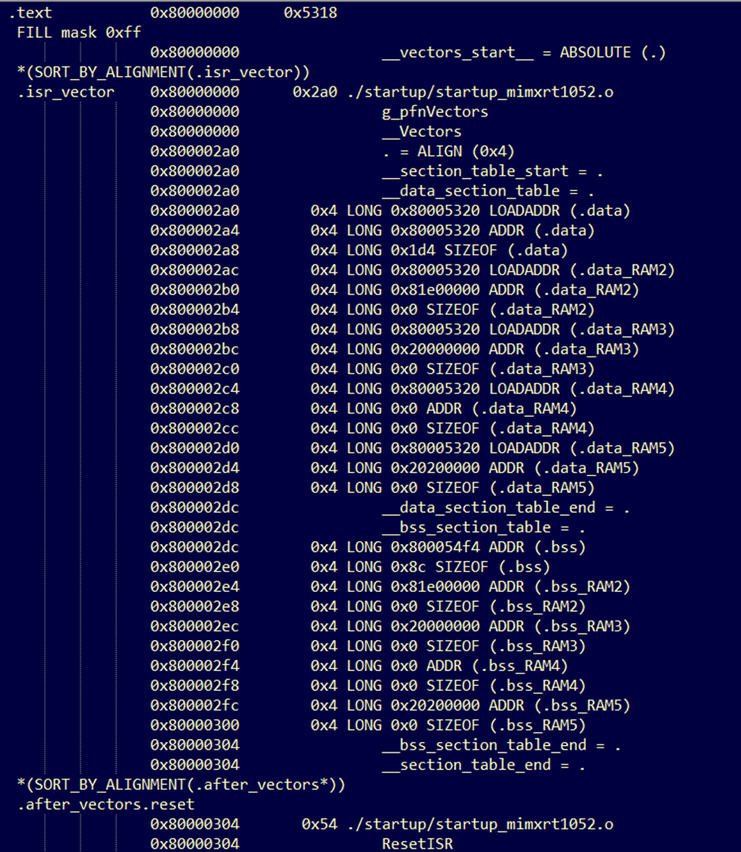

After SDK sample project import completes, if I build the project this is what I see in build console output and MAP file:
What I see in above listings makes me think I am right, but please... again... correct me if NOT.

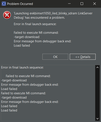

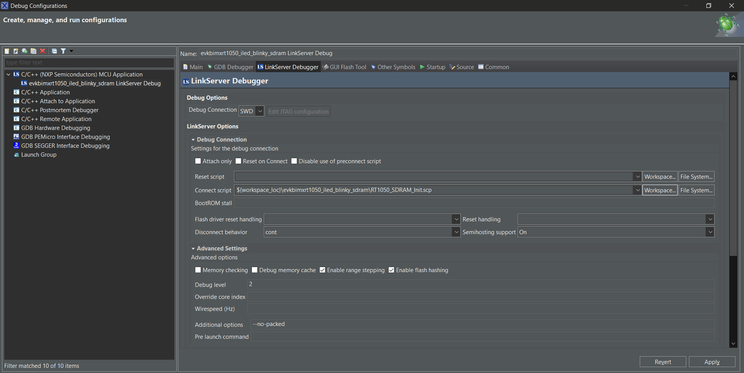

But now, if when I tried to debug the project, this is what happened:
and I said to myself: "Ok, he's right. How could he be able to load the code to SDRAM if nobody initialized it before?"
Then, thanks to this article in NXP community blog I figured out that LinkServer needed a "customized" Connect Script to initialize the Smart External Memory Controller (SEMC) to enable the SDRAM, and consequenly to program and jump to 0x80000000 successfully. The connection script for RT1050 SDRAM initialization is provided at above link, and when added in Debug Configuration something starts to work.

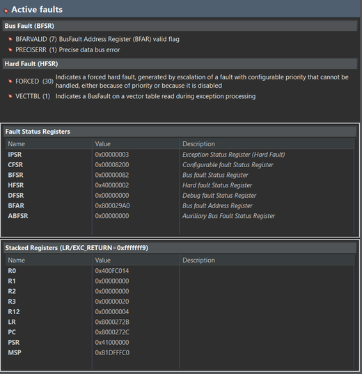

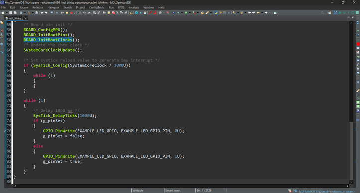

Loading to SDRAM now works, but if I press Resume (F8) then a crash immediately occurs:
The Hard Fault seems to be triggered by BOARD_InitBootClocks(), when SEMC clock configuration is performed. Then I said to myself: "Ok, right. If LinkServer already configured SEMC to support external SDRAM and instruction are fetched from there, it's natural that changing clocks configuration while fetching instructions may cause some malfunctioning. Let's define SKIP_SYSCLK_INIT symbol.

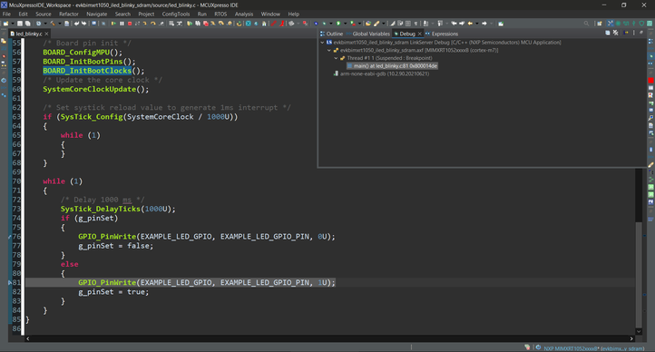

Now, if I start debugging and just press Resume (F8) the program runs and LED starts to blink.

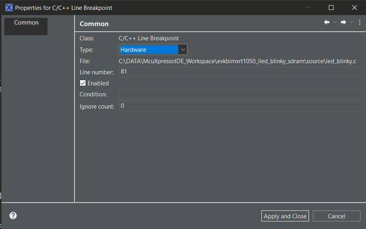

HURRAY! No... wait.... I cannot set breakpoints..... or better, I can set breakpoints, but they'll be never hitted. As you can see in the screenshot below, program is running, breakpoint is set, but no triggering.
The only way to have a breakpoint triggered is to set it up using right mouse button --> Add breakpoint... --> Type: Hardware
HURRAY! Now the breakpoint is working! No... wait.... if I try to step....... it's resuming execution, then stopping when hitting the same breakpoint again...........

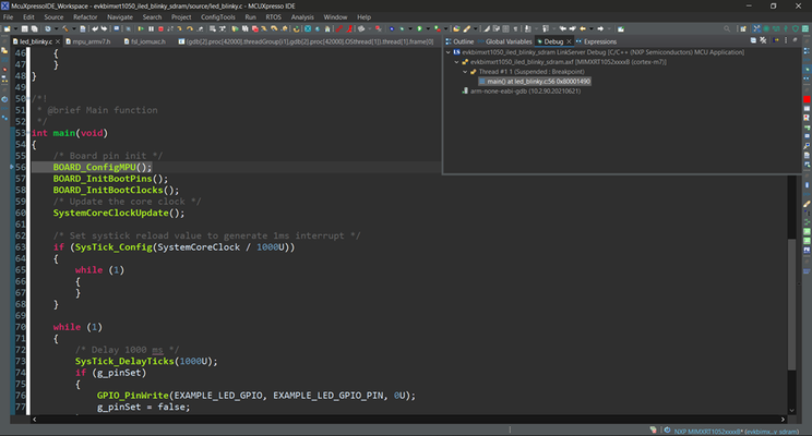

So, debugging was impossible... until I found this thread in NXP forum in which @kerryzhou hinted at --cachelib libm7_cache.so LinkServer option, which I later found also explained in RT1050_BriefOverview_v201.pdf document provided at the same first link providing the connection script too. The document says (let me replace the screenshot, just to make it less outdated):
Debug performance and the Data Cache
When debugging images that make use of SDRAM or OC_RAM for storage of variable data (globals, stack, heap etc.) then the following option should be set within the LinkServer debug launch configuraton as shown below:
This module ensures that debug cache coherence is maintained, and correct debug operations may fail if this module is not specified. However there will be a debug performance penalty when this module is used.
Note: this module is not required io the SDRAM (or OC_TAX) only contains constant or uncached data.

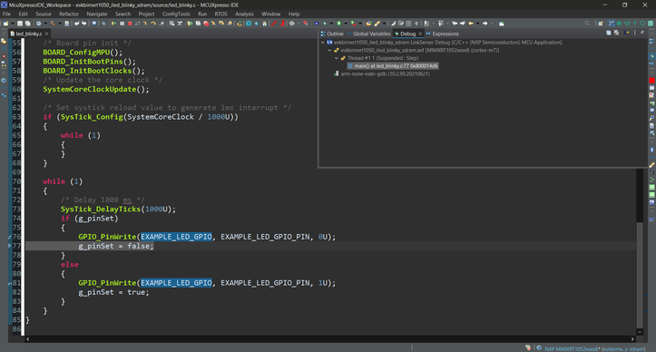

HURRAY! Load works! Execute works! Breakpoints are triggering! Stepping works!
The only drawback is that stepping through the code is reaaaally, really slow.

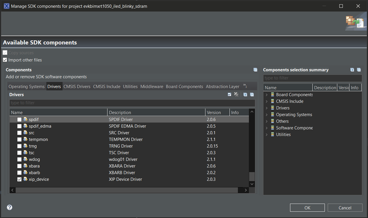

As a very last step, I removed xip_device and xip_board from SDK components, which are no more necessary because now the project is no more executing code in-place from FLASH memory, and I also set XIP_BOOT_HEADER_ENABLE symbol to 0 in both Debug and Release configurations because, for the same reason, I don't need XIP boot header to be included in generated image anymore.

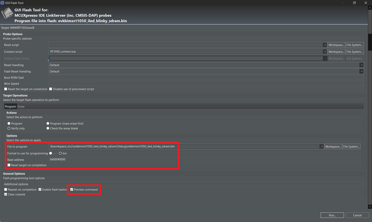

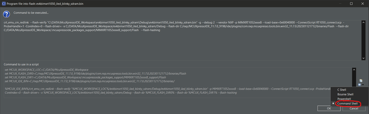

In the end, I finally succeeded also in the second part of the story, the one concerning with flashing my SDRAM application to Hyperflash (or QSPI Flash, doesn't really matter so much) and creating a XIP Second Bootloader copying it from Flash to SDRAM and jumping.
About writing evkbimxrt1050_iled_blinky to external Flash memory, directly from McuXpresso IDE:
I sadly had to accept the fact that it seems impossible to achieve the goal strictly remaining inside the IDE, indeed McuXpresso IDE is offering what's called "GUI Flash Tool" but it fails without any apparent reason in "Ef(11). No flash configured." error if "Link application to RAM" is checked in Managed Linker Script settings.................
Anyway, I did the trick by enabling binary output generation in "C/C++ Build --> Settings --> Build steps --> Post-build steps":
by removing the sharp in front of the second line, then rebuilding the project to generate evkbimxrt1050_iled_blinky_sdram.bin output file: this is the file I had to write in Flash at a proper offset from Flash beginning (to avoid overwriting my Second Bootloader).
Then, to allow GUI Flash Tool working correctly at least one time, I temporarily disabled "Link Application to RAM" option in Managed Linker Script:
and I launched GUI Flash Tool to generate the correct script command to flash, specifying that I would program starting from the .bin file previously generated and I would program at a prescribed address (0x60040000 in my case, but you can decide for yourself):
By checking "Preview command", when I clicked "Run..." button I finally obtained the command I need to invoke from command line (i.e. Windows batch file) to write my Application to Flash:
and that's it, copying-pasting this command inside a convenient flash.bat file added to the root of the project makes it very comfortable to write Application to Flash directly from McuXpresso (double clicking on the batch file from inside the IDE).
A little ending note, for the ones keen to know: leaving "Link application to RAM" flag checked in Managed Linker Script makes GUI Flash Tool invoke crt_emu_cm_redlink without --flash-driver option, which then doesn't open any flash driver and generate "No flash configured" error.

Good post. Also take a look at sections 18.8.5 and 20.6 in the User Guide.
I think reordering of memory regions is not necessary when enabling "Link Application to RAM" is used. However, "soft" reset is kind of a must - the IDE must set PC/SP after downloading the app in RAM.
You mentioned something about the need to force HW breakpoints. If that's what you want, you can instruct GDB to always use HW breakpoints (limited number though) by marking a memory region as read-only - see [1].
If I just check "Link Application to RAM" without touching memory regions order, what happens is that auto-generated linker file links all sections to the FIRST RAM found in that list, resulting in linking everything to SRAM_DTC instead of BOARD_SDRAM.
No, this is NOT what I want. This was simply the only way I found to set an effectively triggered breakpoint (even if after triggering it was impossible to step forward) before discovering --cachelib option for LinkServer. The really annoying point now is that debugging is really very, very, very, very slow. In any case I'll investigate about this option you're mentioning even if I don't know if it may help in resolving /mitigating this speed issue somehow.
