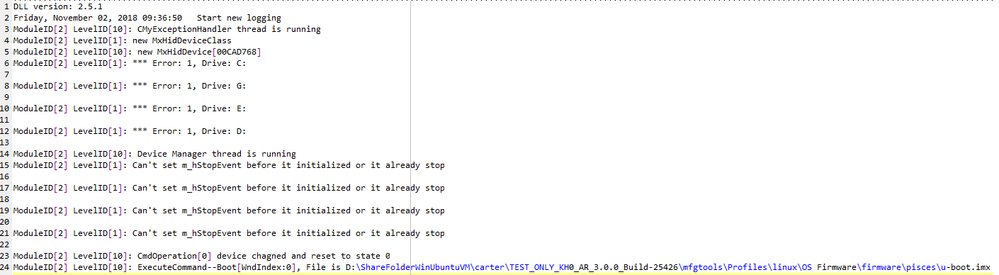

Our processor model is IMX6UL.

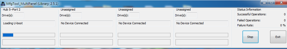

I met a very strange symptom while downloading image into flash through MfgTool.
I used MfgTool to download images(Uboot, kernel, dtb, rootfs).
The result of downloading procedure is pass.
However, target cannot be boot up , even no any uboot log.
This is may due to my wrong uboot image, I am not sure so far.
So, I tried to download images again.
But, MfgTool always hang on "Loading U-boot".
It seems some error while boot ROM handle this command?
Could you help me to re-download images into my target via MfgTool?
By the way, this target is HAB disabled. (I checked this through "hab_status" commnad of uboot)

Hi carter
for new board mfg tool firmware (files in /firmware folder) should be rebuilt
with new ddr calibration coefficients found from ddr test
(put them in uboot/..mx6ul_14x14_evk/imximage.cfg)
i.MX6/7 DDR Stress Test Tool V2.92
Rebuilding is described in sect.6.2 Manufacturing Tool, MFGTool attached Yocto Guide.
igor

igorpadykov
Hi carter
since mfg tool is small linux image the same procedure should
be implemented for it when changing board. Original mfg tool from link
i.MX Software|NXP
was built for nxp reference boards and may not work for other boards.
So new ddr coefficiaents should be changed in uboot/..mx6ul_14x14_evk/imximage.cfg
and mfg tool rebuilt. Below mfg tool overview which may be helpful:
AMF-ACC-T1652
igor

tsung-chihwang
I just found one of root cause.
I downloaded the uboot of sd card to flash..
However, if it hang on wrong uboot, why MfgTool still can find the USB-HID device?
And why I cannot use MfgTool to download correct images to flash again?
