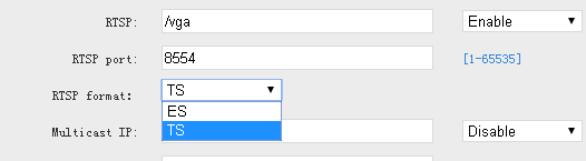

Hi, Victor.
      I found use this commad for VLC server will cause this issue.
vlc -vvv \\192.168.1.253\work\mynfs\AVC_H_L3_Schindlers.list.1993.HDTV.mkv --loop :sout=#transcode{vcodec=h264,vb=1024,acodec=mpga,ab=128,channels=2,samplerate=44100}:rtp{mux=ts,sdp=rtsp://:8554/vga} :sout-keep
      I do not know the "mux=ts" meaning, but your team can try it.
Our RTSP sender is https://detail.tmall.com/item.htm?id=521274714573
When the RTSP_Format choose TS, gstreamer1.0 will cause memory leak, but ES will not.
But using the TS format,  the memory will not increase when playing by gstream0.10(kernel is  use the same one).
Also playing good with gstreamer1.0 by using libav_h264_dec.

This week's update:
With the received HDMI encoder, there will be a 9 bytes package for each 30 frames, this is not a video frame, so it will be held in VPU.
