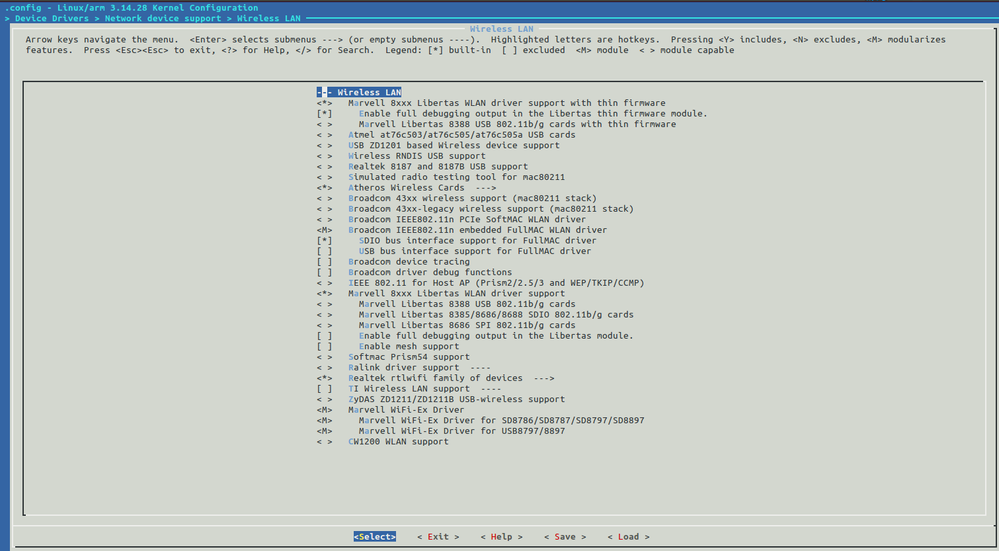

i have marvell 8787 based wifi module.
http://www.t-yuden.com/wireless/WYSBMVGXB.pdf
I want to interface it with imx6qsabresd board running yocto 3.14.28.1.0.1 based linux.
when i connect it to SD2 slot following message appear in terminal.
mmc1: new high speed SDIO card at address 0001
i have driver .bin file and source code with me.
So how to start?

riteshpanchal
thanks for the reply.
in the first link they said to add libertas module by following command
modprobe libertas_sdio
But as you can see in the above attached image of Kconfig there is no libertas available for sd8787.
So how to get this?
And i have source code of the wi-fi module but i unable to cross compile it.
So can you tell me how to cross compile it with my board's linux version 3.14.28?

alejandrolozan1
After delving a little more I noticed that mwifiex_sdio.ko is the one that should be used.
Let me see if there is a way I can get the same wifi chip to test it.

riteshpanchal
i have find suppoert for marvel 8787 in kernel config
and enable Marwell wifi-ex driver  and marvell 8xxx WLAN deiver.
and build kernel image.
And also i added "sd8787_uapsta.bin" in lib/firmware/mrvl in folder.
And after that when i insert the module i got following message
mwifiex_sdio mmc1:0001:1: WLAN FW is active
ieee80211 phy0: ignoring F/W country code US
mwifiex_sdio mmc1:0001:1: driver_version = mwifiex 1.0 (14.66.9.p80)
and iwconfig gives me following output
sit0      no wireless extensions.
lo        no wireless extensions.
mlan0     no wireless extensions.
eth0      no wireless extensions.
and ifconfig not showing me any wifi device.
So whats the problem?
and how to enable module?
And can mlan.ko & sd8787.ko can available for Linux imx6qsabresd 3.14.28-1.0.0_ga+g91cf351? So i can add this instead of mwifiex_sdio.ko?
