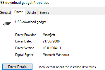

AldoG
This may be due to the host PC selects an incorrect driver model of the USB devices, leading to the PC inability to find fastboot device.
After accessing fastboot, run "reboot bootloader" in console after boot, in host side open "Computer Management->Device Manager", you'll note that the USB appears as:
Universal Serial Bus devices -> USB download gadget,
Right click it, and choose “Updated Driver -> browse my computer for driver software ->
let me pick from a list of available drivers on my computer”, clear “Show compatible hardware” item, then choose “ADB devices”,
Select yes to the pop-up window, this will select the USB as an ADB device,
This should fix the issue, and the fastboot device should be listed.

savedstesen
I have this problem too on Windows 10 and I followed the guide to solve the problem. However the device manager keeps showing "USB download gadget" after installing the Google Driver from https://dl.google.com/android/repository/usb_driver_r13-windows.zip
I would expect something else?
I did try on a MAC with newly Android Studio installed and here fastboot gets instant contact to the device.
Ideas to overcome this?
Svend

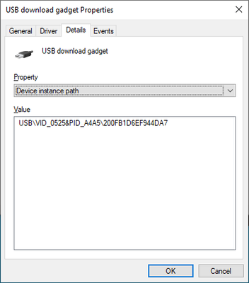

pad_c_jakkahall
Hello Aldo,
We noticed that USB ID getting changed on every build (EVT, DVT, etc). This is causing us to reconfigure windows machines at every build, impacting productivity. What is the reason behind the change?  So far we have seen following IDs.
ID 18d1:4ee7 Google Inc.
ID 0525:a4a5 Netchip Technology, Inc. Pocketbook Pro 903
ID 03f0:0667 HP, Inc
-Pad
