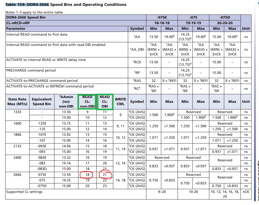

Referring to the latest RPA " MX8M_Mini_DDR4_RPA_v14.xlsx" posted by NXP
According to revision table the CL setting (F28) for MT40A512M16LY-075:E has been updated to be in line with the datasheet and set to 17.
However in the datasheet of Micron P/N: MT40A512M16LY-075:E Table 1 for 075:E speed grade the CL value is 18
Can you please explain the reason for the difference?
I wish to use Samsung P/N: K4A8G165WC-BCTD
it seems from datasheet Table 2 that CL=19 but this value is not an option in F28 drop down menu
Thank you for your support,
Aviad

aviad_h
Senior Contributor I
The -075E ending of Micron P/N implies that speed grade is DDR4-2666 (See Table 1)
To my understanding "Table 159: DDR4-2666" is the corresponding table.1.png1.png
Therefore my question is
1. Which is correct value for NXP Micron P/N: MT40A512M16LY-075:E
2. Which is correct value for Samsung P/N:  K4A8G165WC-BCTD ? Would 18 which is the max value in RPA tool be OK?
Aviad

Yuri
@aviad_h
   1) It makes sense to use  timing parameters for the working memory frequency (DDR4-2400),
       but not for max  frequency (DDR4-2666).
  2) As for the Samsung device - please consult with them for assurance.
Yuri.

aviad_h
I apologize but the answer is not clear.
Can you please explain based on table 158 how this value was chosen, what cell in specific and why? if the value was selected arbitrarily and just tested please notify as well. This is required in order to be able to select correctly value for Samsung device.
Aviad
5,602 Views
Yuri
@aviad_h
   You may select more "safe" value CL=18 (comparing with 17) and check it,
using the Stress memory test. If all is OK and there is - at least theoretical -
option CL=17 - why do not try and test it.
~Yuri.
