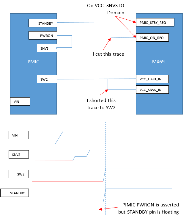

I have had problems booting a board with an MX6SL CPU + PF0100 PMIC.  As a workaround, we have removed support for the SNVS domain by making the following design changes.  I think that all of them are supported by the official Freescale documentation, but I wanted to ask the community if there is anything that I am missing:
See: SR 1-3679179854 and https://community.freescale.com/message/449238
1) Can I short VDD_HIGH_IN to VDD_SNVS_IN external to the MX6SL and drive them both with the SW2 (3.15V) output of the PF0100 PMIC?
2) Can I force the PMIC to be "always on" by shorting PWRON to SNVS on the PF0100?
I think those two things will fix the boot problem at the expense of no longer supporting the SNVS power mode on the MX6SL.  Any gotchas to look out for?
Thanks!

Hi Nathan
I believe yes, answer is positive for both questions.
PMIC start-up behaviour greatly depends on presence LICELL
(coin cell) and it is described in datasheet.
igor

3) The STANDBY pin is driven directly from the MX6SL (PMIC_STBY_REQ pin) to the PF0100 PMIC.  Is there a concern that the PMIC_STBY_REQ, which is now IO un-powered until SW2 is powered, will be in-valid and cause an unpredictable level on the PMIC STANDBY pin at start up, i.e. before SW2 has powered the MX6SL SNVS domain?
4,386 Views
igorpadykov
PMIC STANDBY will take effect when PMIC will be operational,
fully powered.

Then there may be a problem, as shown in this figure.  What does "fully powered" mean in the PMIC? I think you mean that the PMIC is in the ON state, which I think happens when SNVS pulls PWRON high (in my design).  If STANDBY is sampled before SW2 goes high, then it may be invalid because the MX6 SNVS IO domain is not powered.  Is there an internal pull-up/down etc. on the STANDBY pin to prevent problems?
4,387 Views
igorpadykov
"fully powered" mean ON state, RESETBMCU does high on Figure 6 MMPF0100
STANDBY can not be sampled before SW2 goes high, because PMIC
should be in the ON state - this means that SW2 will be in normal state, high.
MMPF0100  Figure 8. State Diagram, Table 22. Standby Pin and Polarity Control
foot note 33 - The state of the STANDBY pin only has influence in On mode.

Great, thanks.  I was concerned that the ON state was entered as soon a SNVS pulled PWRON high. Good to know that ON is only entered after all rails are up.
