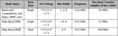

Hi, we tested the eMMC write speed about 10MB/s.  We run the FIO benchmark, the command is fio -filename=/dev/mmcblk3 -direct=1 -iodepth 1 -thread -rw=write -ioengine=psync -bs=4k -size=1g -numjobs=1 -group_reporting -name=test.
As I know, the i.MX6Q didn't support HS200 and HS400. Our eMMC is Micron 8G, the datasheet of Micron has description the max write speed  40MB/s with HS200/400.
We would like know what max write speed is for i.MX6Q?  Thank you.

For 3.3V IO, below speeds are all supported:
• MMC full speed mode (up to 26 MHz)
• MMC high speed mode (up to 52 MHz)
• MMC DDR mode (52 MHz both edges)
For eMMC4.4 or lower (from internet):
the parameters in the list meet those in i.MX6Q reference manual.
Have a nice day!

The max data transfer should be include read and write. The High speed DDR's max data transfer is 104MB/s. We guess this is read speed. Our eMMC datasheet has description this speed is 40MB/s for HS200/400. As I know, the i.MX6Q is not support HS200/400.But eMMC datasheet didn't show DDR speed. So far, we don't know what the ideal write speed should be.

1. IMX6Q uSDHC Data TrThe uSDHC can select the following modes for data transfer:
• SD 1-bit
• SD 4-bit
• MMC 1-bit
• MMC 4-bit
• MMC 8-bit
• Identification Mode (up to 400 kHz)
• SD/SDIO full speed mode (up to 25 MHz)
• SD/SDIO high speed mode (up to 50 MHz)
• SD/SDIO UHS-I mode (up to 208 MHz in SDR mode, up to 50 MHz in DDR mode)
2. VDDIO on Hardware
When you need high-speed mode, the VDDIO voltage of the CPU and EMMC must use 1.8V.
Hope this information is helpful to you.

       Thank you for reply. we would like know which register can select these mode?
       Do you have write speed data for voltage 1.8V ? Our board voltage is 3.3V for eMMC.
       If the voltage is 3.3V, we can run which mode ?
