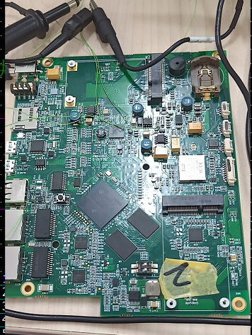

According to the official imx6solox development board, I designed a similar development board,the PMIC MMPF0200F6AEP can be normal  sometimes at the first time  i  power up the  board , the led which controlled by VGEN3_2V8  is always blinking .the output voltage of  MMPF0200  is  not  normal.but  sometimes the PMIC outputs are all normal  ,the led  which controlled by VGEN3_2V8  is lighted nomally,then i  measure the output voltage of  MMPF0200  ,and find that  the output are all normal.can you tell me  why ?

Now I am not connected to a camera, HDMI, LCD, VGA or similar video interface.1.png

I made three boards, one of which works fine no matter how the power is turned on.The other one, VGEN3_2V8 will flash when the power is first turned on, but if it is powered on quickly after power off, the power will work normally.I really don’t know why, do you have any thoughts?

I have never seen this behavior before in application with no camera of other video source connected.
Since your issue is intermittent and not affecting all your boards, I’m thinking that the problem is not caused by a circuit or layout design, but it could be associated with a problem during the manufacture and/or solderability of the boards.
Have you tried to perform a swap test by changing the PMIC from a “good board” (or a new PMIC) to a “failing board” to see if this solves the problem of the failing board? This would confirm if the problem is the PMIC or the board itself.
Make sure the PMIC is properly soldered under the criteria below, otherwise the PMIC could be suffering damage while soldering.
