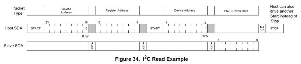

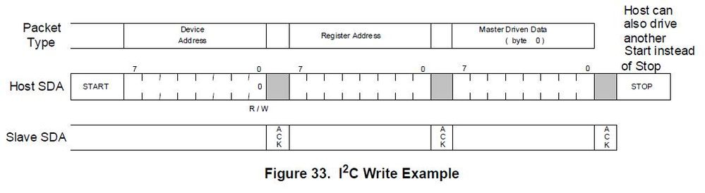

Customer use below command to write value into register.
Write "OTP SW1AB VOLT reg." data :  Device Address = 0x10、Register Address= 0xA0(OTP SW1AB VOLT reg.)、Master Driven Data=0x2B(reg. data)
But the value didn't change by below read command.
Read "OTP SW1AB VOLT reg."  data : Device Address = 0x10、Register Address=0xA0(OTP SW1AB VOLT reg.)、Device Address=0x11、PMIC Driven Data=0x00 (reg. data)
Is this step wrong or miss some step?

Hi m.c.
I think that the problem is that you are trying to read register 0xA0 from the “Functional Page”, and since this register it’s in extended page 1, you first need to access to this extended page 1 to actually read what you wrote on the 0xA0 register: To access registers on Extended Page 1, one must first write 0x01 to the page register at address 0x7F
WRITE_I2C:7F:01 // Access PF0100 EXT Page1
WRITE_I2C:A0:2B // Sw1AB Voltage
READ_12C:A0 //Should read back the expected 0x2B
For more examples, tips and instructions about how to program the MMPF0100 OTP Programming, please take a look at the application note AN4536
