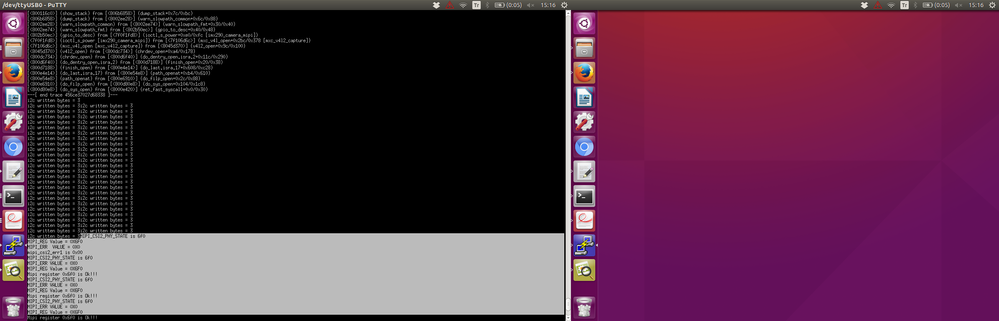

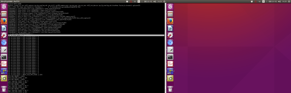

I have been working on imx290 mipi csi2 camera driver on IMX6Q processor Wandboard Quad. I have faced with a problem. The program can start i2c communication with i2c_master_send(); function in my driver. Screenshot from 2017-10-05 14-29-52.png
Right now I am getting  return value 3 from this function before it I was taking -5 (which is errno ) , so I fixed it. But  right now I am getting "mipi csi2 can not receive sensor clk" problem. I checked the D-PHY Status , it is mipi_reg =0x6F0 when we waiting to the mipi clock stabilized , it is not stabilized. When I check the mipi_csi2_get_error1(mipi_csi2_info); is 0x0. How can I check if the status is wrong or right I dont know how to calculate the value. And what could be the reason of this  "mipi csi2 can not receive sensor clock! " error. Screenshot from 2017-10-05 15-16-17.png

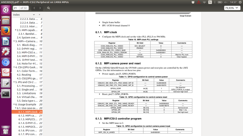

I checked the AN5305 MIPI-CSI2 Peripheral on i.MX6 MPU datasheet and mipi steps but I couldnt find any solution on these documents . I have question about AN5305 document and d-phy status/ clock.
1. Why d-phy csi2 phy state is change  and what thats mean ? fisrt I got 0x6f0 then I made simple change on code then I got 0x200 . What is the reason ? and what this status value means?
2. According to the AN5305 document MIPI clock is going from imx6q to mipi camera sensor. I made my calculation and made the  mipi_csi2_write(info, 0x00000028, MIPI_CSI2_PHY_TST_CTRL1); like this. According to the document sensor clock and d-phy clock should match. So Did I make my calculation wrong or should I change the mipi clock or other things as seen in image below.Screenshot from 2017-10-07 14-57-25.png
I checked the camera sensor clock it generates 37.125 mhz clock inside but I didnt understand what would it be the reason that I can't the clock rate from mipi csi-2 interface
