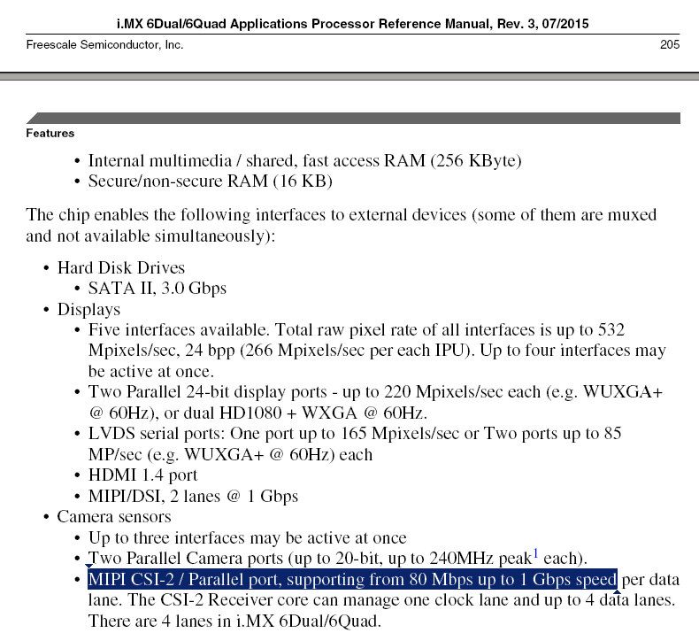

Hi Kapil
i.MX6 MIPI CSI-2 supports up to 1 Gbps speed
steps for supporting new camera are given on
Some Experience When Enable MIPI Camera
igor
