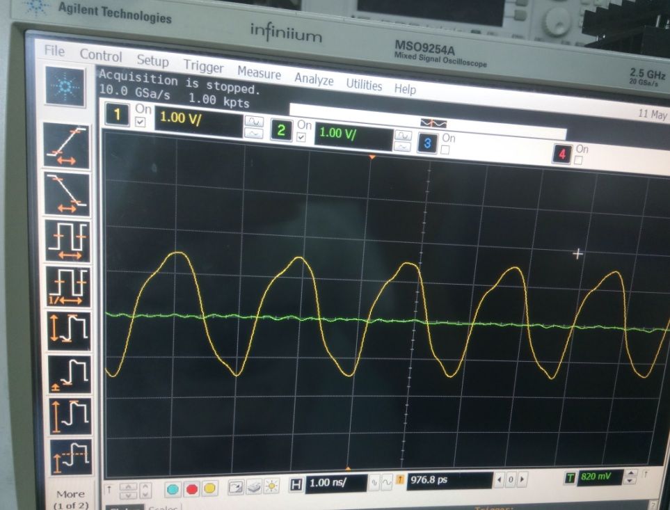

But I found an interesting phenomenon. When I tested signals DRAM_SDCLK1 or DRAM_SDCLK1_B between DDR and I.MX6D with oscilloscope, the software could be downloaded successfully.When software downloading, the probe of  oscilloscope should be kept on the testpoint of DRAM_SDCLK1 or DRAM_SDCLK1_B, and should not be moved away. So what's the reason?

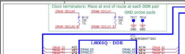

this may be caused by noise on SDCLK signals, on one can tweak termination resistors R118, R43
as depicted below from spf-27392 sabre sd schematic
igor

I have exchanged resistors R118, R43 value from 200 to 130, 150, 220, and 270, the problem was still not solved. And when resistors R118, R43 value were 200, I have measured  the signal SDCLK with  oscilloscope, the signal was good.
So, what about other factors?

also one can add small capacitors to decrease ringing.

I finally found the reason.The amplitude of DRAM_SDCLK0 was about 1V smaller than the amplitude when the board was OK, because one DDR was not soldered well. After I heated the DDR, the amplitude of DRAM_SDCLK0 was OK.
I removed the R118 and R43, and replaced them with 2.7pF capacitors,  the software could be downloaded successfully, and also these boards could boot from eMMC successfully.
So, I replace R118 and R43 200Ω with 2.7pF capacitors, the Vp-p amplitude of DRAM_SDCLK0 and DRAM_SDCLK1 is about 3.0V, Is there any risk?

replacing R118 and R43 200Ω with 2.7pF capacitors seems as
good as @528Mhz it gives about 100Ohm as requires Hardware Guide for
differential lines impedances.

Resistors R118, R43 value were 200 in abnormal board,  one board sometimes was OK and sometimes was abnormal. When the board was abnormal, the amplitude of DRAM_SDCLK0 was about 1V smaller than the amplitude when the board was OK.
