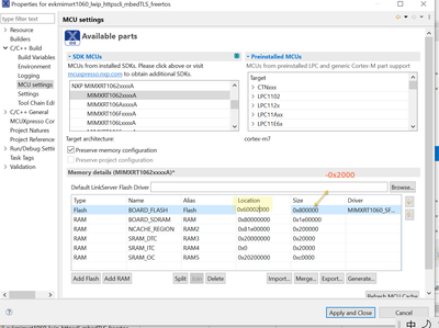

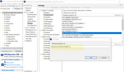

engi_2068
I appreciate the help.
I tried changing the XIP_BOOT_HEADER_ENALBLE to 0
and changing the BOARD_FLASH from 0x6000000 to 0x6002000.
After flashing with MCU Boot Utility with the .s19 created from the MCUXpresso .axf, the program did not run and genreated zero output.
The SPI readback function is simply a function that is reading bytes from a peripheral and checking that it responds with the same data it sent. This data lives in  a static const uint8_t [2014].
The code when run from MCUXpresso using the "Debug" option does not fail at this point and works as it should.
3,912 Views

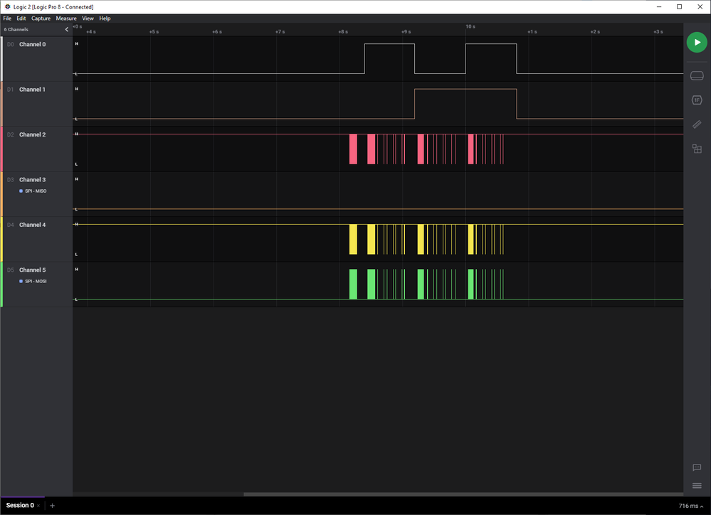

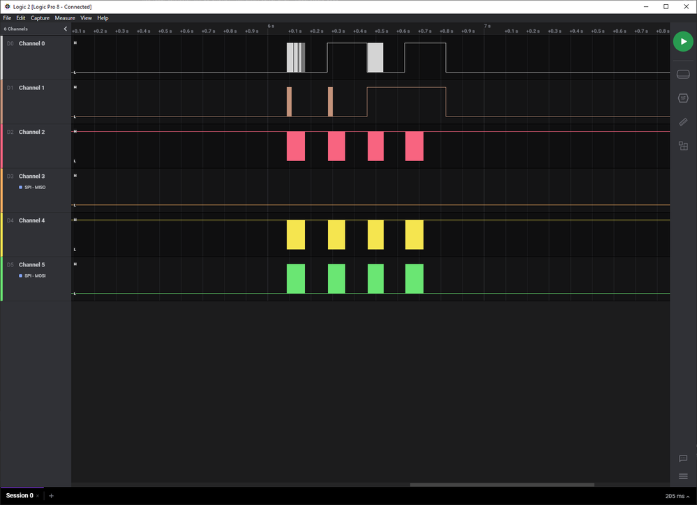

I have a two GPIO outputs tied to GPIO_B1_02 and GPIO_B1_03 as seen here:
which control an SPI Chip Select Mux.
In the debug MCUXpresso version I seem normal stable behavior. You can see the CH0 and CH1 cycling between 4 peripheral SPI devices whose CS lines are attached through the mux output.
However, in the axf version run through MCU Boot Utility I see unstable behavior on these pins.
So, debugging/attaching the AXF/s19 which is running after reset from the MCU BootUtility shows error on SPI reads. I can see now that unstable behavior on the CS mux select is likely the issue.
However, I only see the behavior when the axf/s19 is run through MCUBootUtility and booted. However normally when run from "Debug" inside MCUXpresso, the lines are stable.

engi_2068
Okay. Even more debug.
Those flakey lines were my bad. My logic analyzer was not setup correctly. I can confirm that the data on the LINE is perfect.
Dumping the interpreted data to and from the peripheral device is perfect.
However, the data read back from the LPSPI 1060 peripheral is seemingly bad.
The .rxdata struct has the wrong data when then LSPI RTOS functions return.

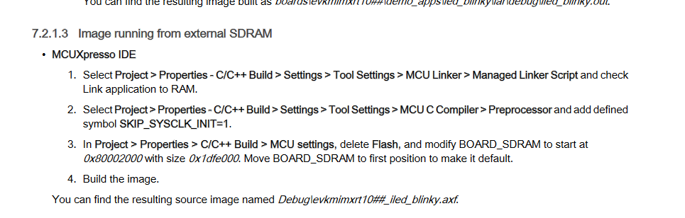

kerryzhou
Hi @engi_2068 ,
  Don't worry, the issue is easy to resolve!
  Your app project works OK on the IDE, and then after generate the file, then add it to the SPT tool or the MCUBootUtility tool, you meet issues, right?
  to the MCUbootUtility tool
   You can refer to this app:
NXP-MCUBootUtility-3.5.0\apps\NXP_MIMXRT1060-EVK_Rev.A1\led_blinky_0x60002000.srec
When you generate the code in the MCUXpresso IDE, just need to do this operation:
Then, generate the srec file, and add it to the SPT(secure provisional tool) or the MCUbootUtility again, it should works.
As the tool will help you add the FCB header.
About the code, I suggest you use the SDK code at first.
About the  SPI memory read back comparison code, how do you read the memory? Use the code run in the flexSPI flash? As the chip can't support the RWW, you need to copy the flash operation code to the internal RAM.
