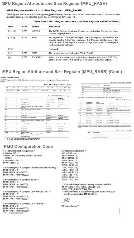

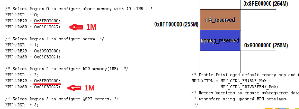

BiyongSUN
You can not comment the code, instead, you need to add the code to configure the MPU(menory protect unit).
please check the attached patch.
The memory layout like following:
26,548 Views

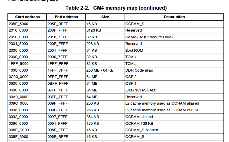

BiyongSUN
At lease the  code following is wrong:
OCRAM from M4 side is 0x20900000, which is already set in bar 2 in the sample code.
wrong code
/* Select Region 1 to configure share memory with A9(1M). */
    MPU->RNR  = 1;
    MPU->RBAR = 0x900000;
    MPU->RASR = 0x30B0021;
Table 2-2. CM4 memory map
26,547 Views

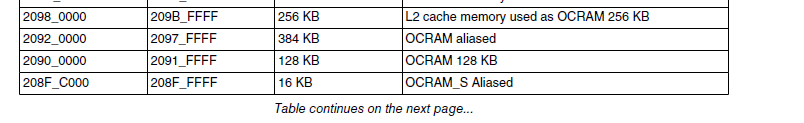

imanolallende
Both appear in the CM4 table:
26,548 Views
