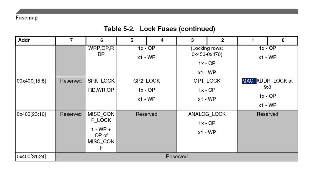

I have a little question. How can I lock the MAC address fuses?
I have set the MAC address with
U-Boot > fuse prog 4 3 0x000000aa
U-Boot > fuse prog 4 2 0x11223346
and I get the MAC address 00:aa:11:22:33:46. But then I can do
U-Boot > fuse prog 4 2 0x11223347
and now I get the MAC address 00:aa:11:22:33:47
Is there any fuse prog x y z to lock the MAC address writing?

igorpadykov
HI Anonymous
suggest to check IMX6DQRM  Table 5-2. Lock Fuses
igor
2,792 Views
_andev_
Then this is translate to a
fuse prog 0 0 0x300 ???

igorpadykov
Q&A: How to program i.MX6 eFUSE?
https://community.freescale.com/docs/DOC-95458
