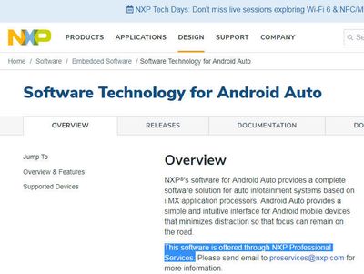

igorpadykov
Hi Vinothkumar
sorry, "Rear View Camera" as part of Android Automotive is supported through
NXP Professional Services as described on below link
https://www.nxp.com/design/software/embedded-software/software-technology-for-android-auto:ANDROID-A...
igor
3,332 Views
