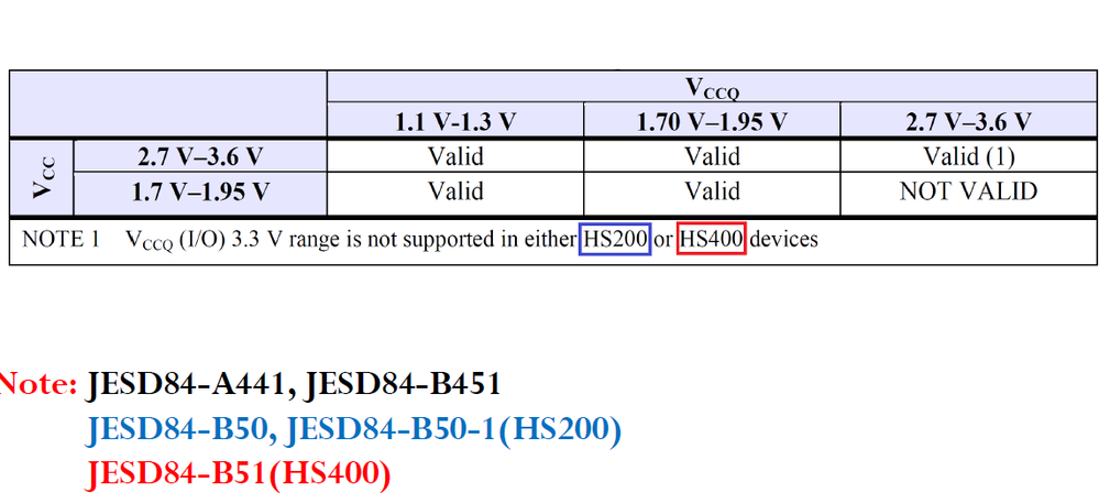

for emmc voltage, if you read the spec, the emmc io 1.8v could work for high speed and legacy speed both. So far, it is not emmc issue.
emmc is not sdcard, sdcard has voltage select when init. and emmc and sdcard belong to different spec.
This is from  emmc jedec spec, emmc io could be 1.8v for all speed.
you can double check the hardware mmc io is 1.8v or 3.3v or add  no-1-8-v to the device tree(linux\Documentation\devicetree\bindings\mmc\mmc.txt) to try.

The problem is that the eMMC is not responding to the selected voltage, usually is because the memory uses a different work voltage than the one you are using, one could try to move the BOOT_CFG[1] that change the operating eMMC voltage.
Other stuff that probably is causing this and we could try:
1. reason may be poor soldering, one can resolder eMMC or change from a known good board.
2. one can debug it using an oscilloscope or digital analyzer and sect.7.4.2 Operating voltage range validation eMMC specification:
http://yourcmc.ru/wiki/images/5/55/EMMC_JESD84-A441.pdf
