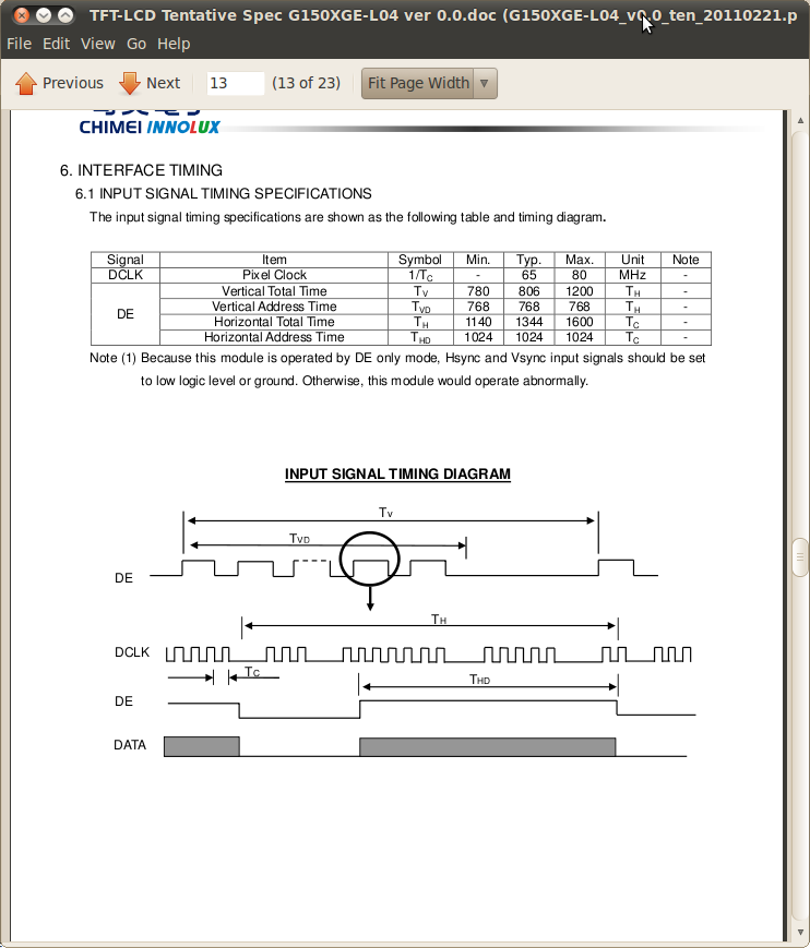

Is there any chance to set the Vsync and Hsync Signales/Bits fixed to low?
I am trying to use a LVDS display that comes with these restrictions.

Unfortunately the display that my customer wants to drive specifically states that it requires Vsync & Hsync to be low, as opposed to the display that we use on the SDP which doesn’t even mention Vsync (VS) or Hsync (HS)
See page 16 of the attached datasheet and note 1
Instead of "blocking" the vsync/hsync signals from entering the LVDS block (which may not be possible), perhaps we can think of another work-around?
  For example, if we could convince the IPU __not__ to generate any vsync/hsync waveforms, we'd be high and dry. The waveforms are set up in file ipu_disp.c, function ipu_init_sync_panel(). But !! The setup is very complicated, and I do not understand what it does, even when reading the relevant sections in the manual

Hi John, if the customer doesn't need IPU to output the vsync and hsync to LVDS, they can mody the followed code in ipu_disp.c, function ipu_init_sync_panel():

It seems the VSYNC and HSYNC is must in LDB side to convert the display signal to LVDS serial signal.
Another thing can be tried is to switch the low/high active for HSYNC and VSYNC, the original seting is low active:

Hi Marco, there is no solution to set both signals "permanently" to LOW for LVDS panel. In iMX6 internal, the IPU display interface will output parallel video data to LVDS module, then LVDS module will convert this parallel input to LVDS serial signal and output from LVDS port, for such convert, VSYNC and HSYNC is needed, so IPU DI must output valid VSYNC and HSYNC to LVDS, and the LVDS bridge will always fill the HSYNC and VSYNC data into LVDS package.

Hi John, if the customer used parallel panel, the use case can be supported, but for LVDS panel, it can't.
By the way, from LVDS panel side, when converting the LVDS signal to parallel RGB signal, maybe the customer can disconnect the HSYNC and VSYNC pins.

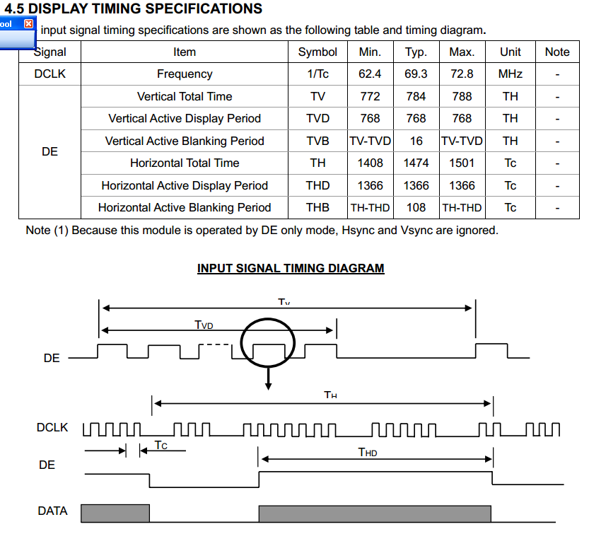

I have also a lcd display with DE only mode, and i can't set hsync and vsync to low, when I set hsync_len and vsync_len to zero in ldb.c i have a error when boot my board.
Is that someone have a solution ?
this is the timing of my lcd :
Fabien.

So, did you just add a new data inside ldb_modedb[] struct in ldb.c? how did you compute for the pixclock? did you just set hsync_len and vsync_len to zero then, since they are being ignored in DE mode?
5,401 Views
Martin1z
I have calculated the pixel clock manually. But you will also find some macros in this forum: Linux Framebuffer driver: Calculate Pixel Clock for struct fb_videomode -blog archive
VSync and HSync pulse width is not set to zero as I think this is not valid configuration. In my case these signales are discareded automatically by the LVDS converter on my display. So only DE signale is connected to the LCD display. My first proposal therefore was not correct that it is required to set these signales to fixed low.
Do you have comparable problems with LVDS disaplay?
In my cause the problem was cause by an invalid pixel clock. Unfortunatly the default PLL used in LVDS driver is to fast to achieve clocks below 40MHz. Therefor I needed to select another PLL for lower display clocks.
5,401 Views
Jon1z
Basically I'm having trouble dealing with the timings and stuff. Here is the datasheet for my lvds lcd.
Now since my lvds is in DE mode only, it also disregards hsync_len and vsync_len. and since there seems to be no mention of hsync or vsync, I thought I should set them to zero as well. That leaves my calculation of pixclock to have hsync and vsync to be zero since both are part of the function to get pixclock. I just haven't tested the "zero hsync and vsync" since the lcd haven't arrived yet, but as you mentioned, a zero configuration seems an invalid configuration so I am lost now what to put as vsync_len and hsync_len...

The VSYNC signal from IPU to LVDS Bridge (ipu_di0_vsync) is internally only. So in my understanding the only location to adjust this might be in the LDB.
Meanwhile I have detected that this wasn't the reason for my problem. The LVDS circuit on the Display itself discards the sync signales (and uses DE only). Hence I think that the option I was searching for will never be required!
